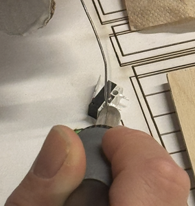

In the final version, we improved the mechanism for pulling down and contracting the force. We initially attempted to use a solenoid, but it lacked the power to achieve the desired "blast-off" effect. After testing various sensors to detect garbage, we selected a micro limit switch due to its high sensitivity in detecting even slight pressure.
TT Motor with Gear:
The gear is connected to the TT motor and attached to a surface linked to a spring. When the sensor detects an object, it activates the motor, causing it to pull down the surface and create a "blast-off" effect. Through the gear system, the motor contracts the surface back into position.
Micro Limit Switch:
The micro limit switch is a highly sensitive push button that sends a signal when it detects minimal pressure, making it ideal for accurately sensing garbage input.

  2. Then, have the Arduino with a Micro Switch in the center of the base. This helps detect user interaction and activates the throwing motion.
  3. Lastly, connect the springs on the top layer to the bottom of the middle plywood panel. This will provide the necessary force for the upward and downward motion.
Ps: the Micro Switch didn't have enough length to reach into the breadboard so we wired it to another wire to extend it
