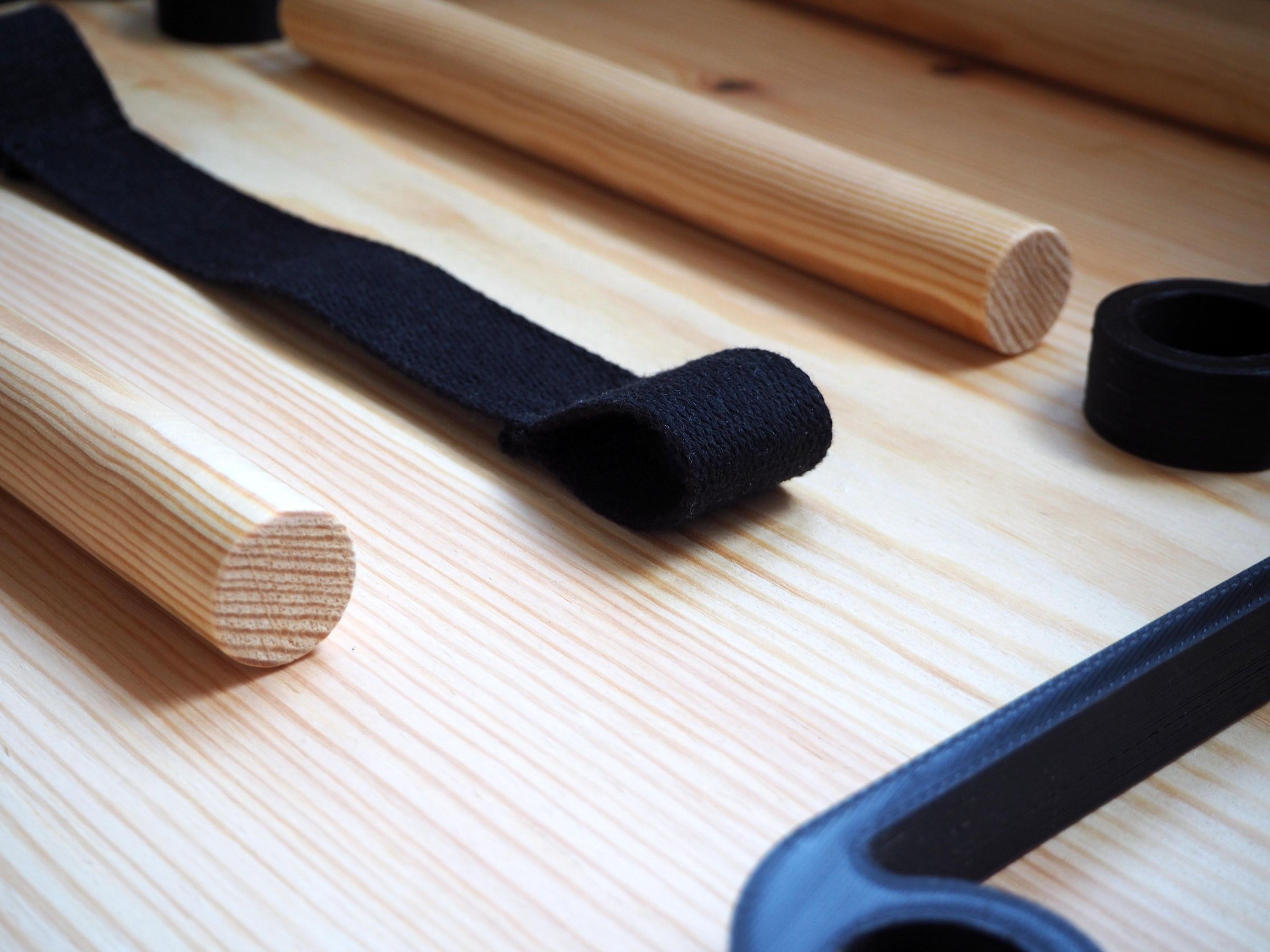

Step 4: Fabric
The fabric strap used in Note holds the stand together and makes it easy to fold and stow away when not in use.
  1. Find a strap with a width of approximately 34 mm (1.34 in) and a length of at least 420 mm (16.54 in)
  2. Cut the strap into a length of 420 mm (16.54 in)
  3. Make a loop in each end by folding the strap 116 mm (4.57 in) from the ends of the strap
  4. Sew the loops in place
Customization
If you want to customize the angle of the final stand you can use a longer or a shorter strap. Keep the loops in the ends of the strap in the same size and your customized strap will work fine.
