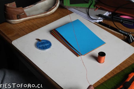

When all holes are ready, grab the first set of folded sheets and start sewing into the inside of the sets. Start from any hole that is near the edge. Use a regular sewing thread. Join the sections together at both ends with knots.

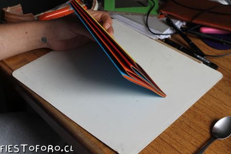

Once all the sets are sewn, we need to glue a piece of cloth. This will keep the sections fastened together, specially when the book is opened between the sets.
Find a regular piece of cloth, from a discarded shirt for example. It should cover the back of the sections and extend around 1.5cm (0.6in) around the first and last page (Please see last photo of the set).
Apply adhesive to the back of the sets and half an inch on the first and last page of the notebook, then attach the piece of cloth. Finally make sure the piece is glued to the sheet and trim any excess.
