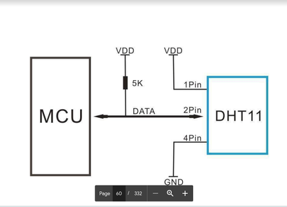

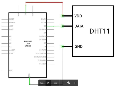

Step 3: Complete Breadboard
Your breadboard may differ from mine and it's okay because there are a variety of ways to construct the breadboard. You will need to add the dht sensor and led light to your breadboard.

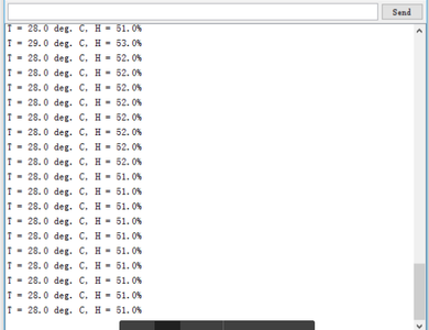

Step 6: Test DHT Sensor
This step is crucial in the progression of this project. It is important that you can see the data from the dht sensor on a serial monitor because it ensures that the programming and breadboard are correct.

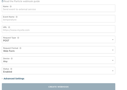

Step 7: Set Up Webhook
Create a webhook, which will be used to trigger the notification on your specified device.
