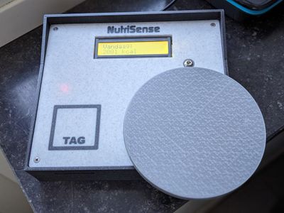

The 3d print file (case) are in the zip file. The tags are equipped with RFID stickers. There's no need to write data in the stickers because they all already have a tag ID from the factory.
Print the tags with the 3D printer, put a sticker on it and provide the tag with an image.
All electronics go in a 3D printed case. The load cell is attached to the lid with two M4 screws.
Step 3: Conclusion
It was a fun project, especially because of the large number of different modules, all controlled by a single Arduino sketch. It did take a few iterations, though. Also, everything got quite warm inside, which has been resolved by adding simple ventilation holes. All the electronics are mounted on the lid, eliminating the need to run wires from the panel to the case.
