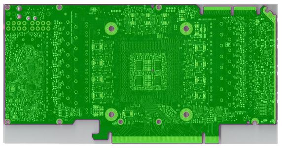

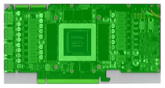

Step 9: Appendix... Model the PCB With Important Sizes
Scans were taken of the card.
The PCB was modeled in Solidworks and the scans were overlayed.
Some important chips were added, along with the backplate and the main connectors.
Some important sizes were taken.
The GPU PCB measures 50.98x50.98mm with a 3x45° chamfer on the top left corner
The mounting hole pitch is 67.54x58.72mm with 4 off Ø3.8 holes.
The GPU chip measures 26.8x23.4mm.
The GPU contact face is 2.81mm above the PCB.
