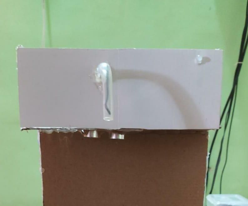

This undertaking depicts about a obstacle evasion robot vehicle that is constrained by ultrasonic sensor. The robot prototype vehicle is controlled by Arduino microcontroller and uses ultrasonic sensor for obstacle detection. This sensor is fixed in front bit as well as two sides of this vehicle. The sensor gets the data starting enveloping zone through connected sensors on the robot. The sensor senses the obstacle and go in its approach to pick an impediment free way. The sensor will send the instruction to the controller and is stood out from controller with pick the right motion to the robot wheel. The vehicle wheel now advancement and heading will be established on the identifying of the ultrasonic sensor and besides using a wheel encoder. This vehicle is used for perceiving obstruction and avoiding the effect.

Step 2: Assemble All the Components on the Desired Chassis Using Nuts and Bolts
The first and the most important step is to make the chassis ready using proper nuts and bolts and the desired components.
