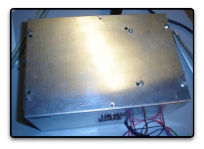

Step 5: The Enclosure - Circuit Mounting
The brains for the OEM laser diode is the laser diode & temperature controller circuit. To mount it to the box, you will need to remove the 15 pin D-dub connector nuts from it first. Attach 4-40 tapped standoffs 3/8" long on the 4 corners of the circuit and put it in the box.
Now attach the front plate to the box and feed the 15 pin D-sub connector on the circuit through the plate. Reattach the D-sub nuts and tape down the front plate to the box. This is where you will now make the holes to mount the front plate to the box. Also, if you need to remove some material from the display panel access hole, I'd recommend using a nibbler. In a perfect world you won't have to remove material, but let's be realistic here...
Their are 4 holes that mount the front plate to the box and these are where you will use your center punches to center your drilled holes. Once the holes are center punched, remove the front plate and circuit from the box and use a #43 drill bit with the pin vise to finish the holes. I found that using a pin vise was easier than trying to get a drill press to do the job. You should use 4-40 sheet metal screws to fasten the front panel to the box.
Unfortunately, all the parts from Thorlabs are metric. This means that a 4-40 screw will almost fit into the clearance holes of the front plate. They do fit, but they are really snug. Just keep this in mind when you go to mount the front plate. The same applies to the 4-40 standoffs on the circuit board.
The circuit board still needs to be mounted to the box. You can either glue the standoffs to the box or you can try and make holes in the box using your hand punch. We opted to mount the circuit to the box, but in doing so, we screwed up several times with the hole placements. Using the hand punch to make holes that are oversized is a great idea, just use washers when you screw things in.
In retrospect, I'd go with gluing. It's faster and easier. If you go this route, make sure your glue rocks otherwise your circuit will fall and fail. (The main reason why I didn't want to do this in the first place.)
