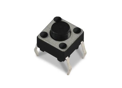

  • Button

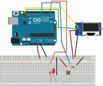

Step 2: The Circuit
  • Connect OLED Display pin [SCL] to Arduino pin [SCL]
  • Connect OLED Display pin [SDA] to Arduino pin [SDA]
  • Connect OLED Display pin [VCC] to Arduino pin [5v]
  • Connect OLED Display pin [GND] to Arduino pin [GND]
  • Connect Arduino Digital pin [7] to button on the breadboard and to the Resistor1
  • Connect other side of the resistor1 to the breadboard pin [GND]
  • Connect Other pin of the button to the breadboard positive pin [5V]
  • Connect Arduino pin [5V] to breadboard positive pin [Red line]
  • Connect Arduino pin [GND] to breadboard negative pin [Black line]
  • Connect Arduino Digital pin [2] to the Resistor2
  • Connect other side of the resistor2 to the LED positive pin
  • Connect LED negative pin to breadboard pin [GND]

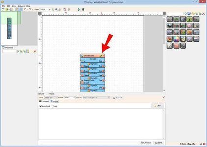

Step 3: Start Visuino, and Select the Arduino UNO Board Type
Start Visuino as shown in the first picture Click on the "Tools" button on the Arduino component (Picture 1) in Visuino When the dialog appears, select "Arduino UNO" as shown on Picture 2

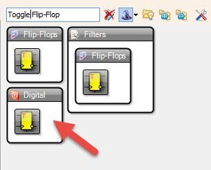

Step 4: In Visuino Add Components
  • Add "Clock Multi Source" component
  • Add "Toggle(T) Flip-Flop" component

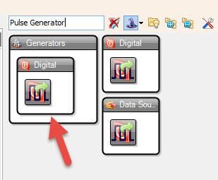

  • Add "Pulse Generator" component
  • Add "Start" component
  • Add "Up/Down Counter" component
  • Add "Digital Multi Source" component
  • Add 2X "Integer Multi Source" component

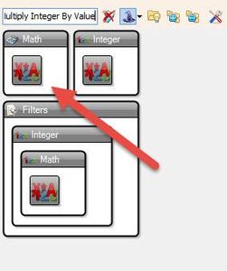

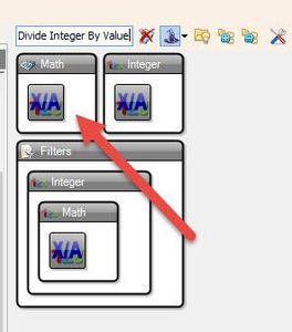

  • Add "Divide Integer By Value" component
  • Add "Multiply Integer By Value" component

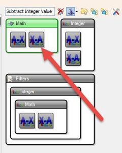

  • Add "Subtract Integer Value" component
  • Add "Compare Integer Value" component
  • Add "Formatted Text" component
  • Add "OLED I2C" component

  • Select "PulseGenerator1" and in the properties window set "Enabled" to False, and click on the pin icon and select "Boolean SinkPin"

  • Select "DivideByValue1" and in the properties window set "Value" to 60

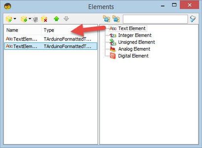

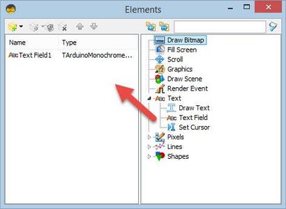

  • Double click on the "FormattedText1" and in the "Elements" window drag 2X "Text Element" to the left side and for both set in the properties window "Fill Character" to 0 and "Length" to 2
  • Close the "Elements" window

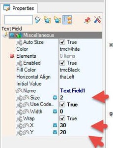

  • Double click on the "DisplayOLED1" and in the "Elements" window drag "Text Field" to the left side and set in the properties window "Size" to 2, "X" to 30 and "Y" to 20
