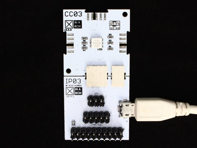

Step 4: Programming the CC03
Click in an IP03 xChip onto the CC03 using an XC10 and XC55 connector and plug into a USB port on your computer via micro-USB cable. Connect as shown in the picture below. Open Arduino and select the correct COM port. Under Tools select Board: "Arduino M0", then upload the sketch, which I will provide in the code section of this page.

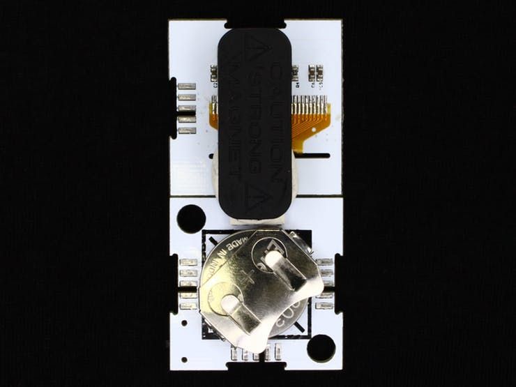

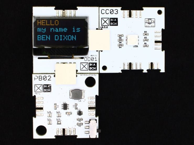

Click, click click, DONE!. The xChips make it very easy, simply click them together with the XC10 connectors. The only thing to bare in mind, the small XinaBox logos with chip name must all face the same direction, the bus at the top and bottom of the board are NOT the same. Then put a CR2032 into the back of the PB02 for power. When you're finished it will look something like the picture below.
xChip Assembly Complete

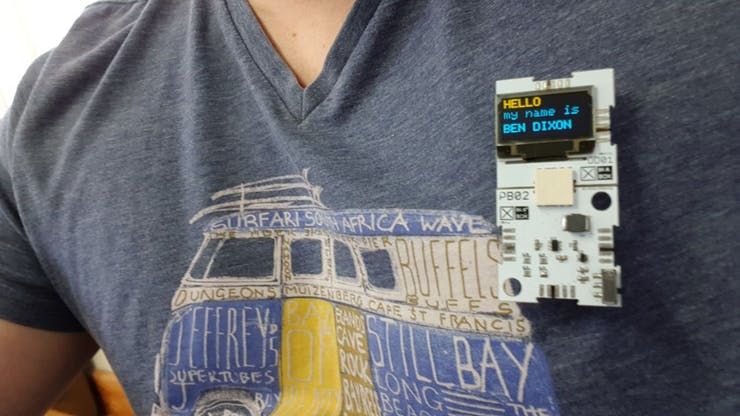

Now if you want to mount it on your shirt, you will need to mount a badge magnet on the back of the device using some sticky tape or something of the like. Look at how I did it below.
Badge Magnet mounted on back of OD01
Step 6: Running It
Switch on at the power switch of the PB02. Pull out the CC03 after the text is displayed and VIOLA! Mount it on your shirt and have fun with it! The completed name tag uses less than 4 mA to operate, so you can expect about 55 hours of operation out of a CR2032 coin cell battery.
