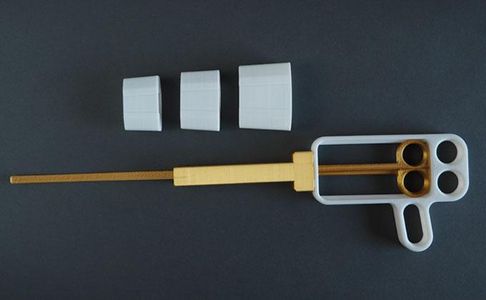

Step 2: Attach CORE to HANDLE
You've printed everything right? Got all your parts ready to go? Great!
Do whatever you gotta do to make these two parts look like the picture on the right. Without breaking anything.

Step 5: Attach the Three CORE SEGMENTS
Slide/press the core segments down over the core. There's only one way all three core segments fit properly.
Take care not to kink the tendons

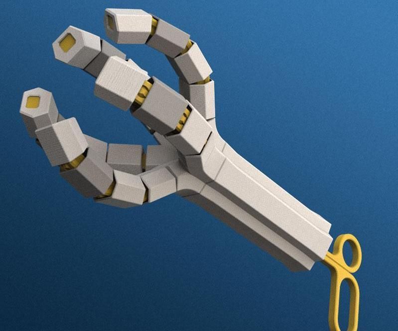

CONGRATS! YOU'VE MADE A TENTACULON!

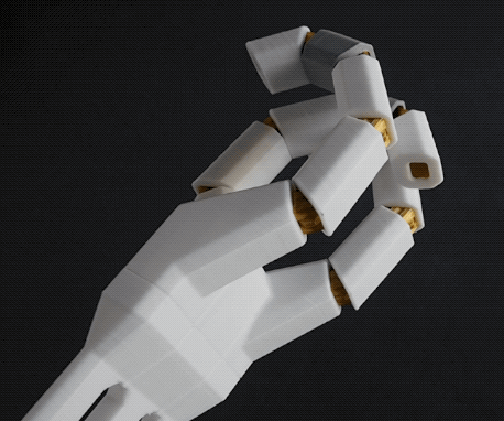

Remember this is a puppet at heart. Play around with it and see how it moves and behaves. If you tilt it up or down, does gravity affect how the tentacle moves? Try fast moves, slow moves, big moves, and tiny moves. Try to give it a little personality! Have fun and send me pics or gifs of your Tentaculon in action!
