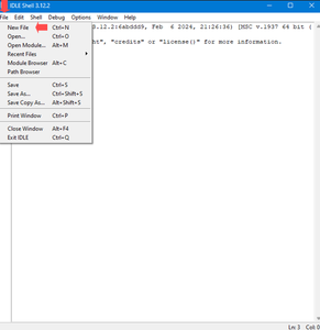

Step 1: Launch
Launch IDLE on your computer, click the ‘File’ tab, then click ‘New File.’

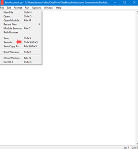

Step 2: New File
Click the ‘File’ tab, then save the newly created file as BankAccount.py.

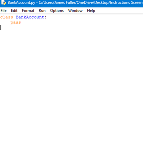

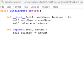

Step 3: Class Definition
Define the class. Each definition should be formatted in the corresponding figure (i.e., Step 3 = Figure 3). This is what makes a BankAccount its own type.

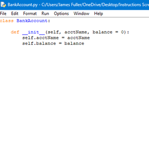

Step 4: Constructor Definition
Define the constructor method to allow your class to initialize attributes. This step allows you to initialize the BankAccount and its attributes.

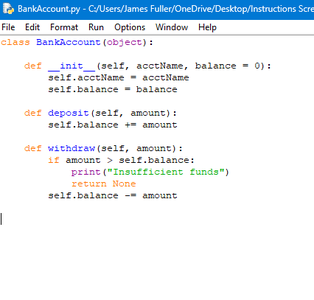

Step 5: Deposit Definition
Define the method to deposit money. Now, the BankAccount can increment its instance amount.

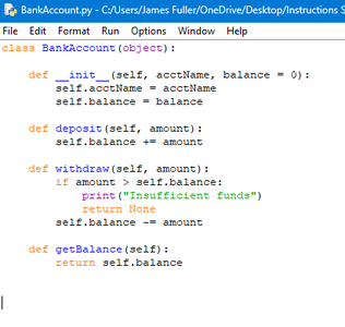

Step 6: Withdraw Definition
Define the method to withdraw money. This gives the BankAccount a way to withdraw money only from what the account has.

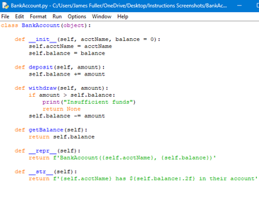

Step 7: Balance Definition
Define the method to check the balance of a BankAccount object.

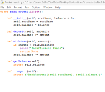

Step 8: Formal String Definition
Define the formal string representation method of a BankAccount object. This returns the canonical representation of the BankAccount object.
Step 9: Informal String Definition
Define the informal string representation method of a BankAccount object. This returns a readable version of the BankAccount object.

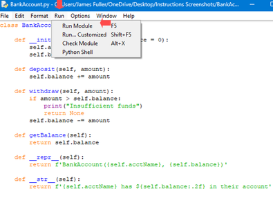

Step 10: Save Your Work
Save your program, click the ‘Run’ tab, then click ‘Run Module.’

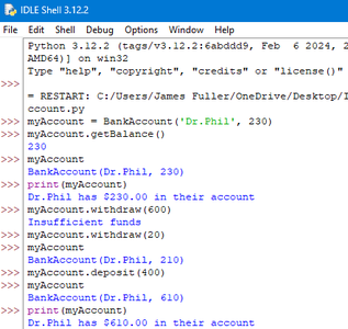

Step 11: Troubleshoot
Verify that your object is working as expected with the test code in Figure 11.
Step 12: Conclusion
Congratulations on completing this step-by-step guide on creating a bank account class in Python to learn the basics of OOP. You should now have a class that encapsulates features such as deposits, withdrawals and a way to print out the object itself. To ensure the program runs correctly, check for syntax errors and verify that you follow the correct method calls. Also, check for logical errors, particularly in the conditional checks of your methods. Keep experimenting with your code, as that will only bring you closer to mastering Python and OOP!
