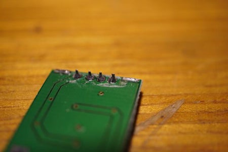

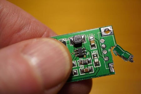

Step 2: Prepare the Voltage Step Up Module
First, remove the USB plug from the module.
Next, we need to shorten the module a bit.
Pic. 1:Cut away as much as possible. But don't cut off the USB solder spots.
Pic. 2: Grind down until short enough.
Then remove the remaining tin-solder and remains of the USB plug.
Pic. 3: We need to get rid of those four dips on the underside of the module.
Pic. 4: That's what we want! All clean now.

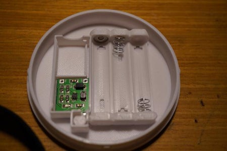

Step 4: Install the Voltage Booster Module
Before we can continue with the rest, we put the Voltage Booster Module in its right place.

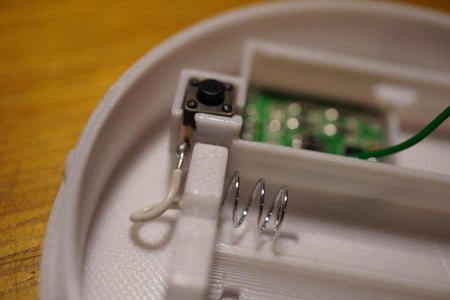

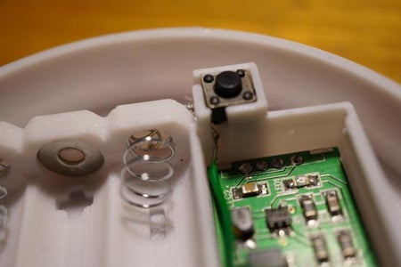

Step 5: Install Push Button
Use a short 0.5 diameter single wire and strip it on both sides. One shorter, the other longer. Now, place the longer blank wire into the last Minus (-) pole and push the last spring in there.
Now, take the push button and solder that wire with the shorter blank end onto one of the terminals, so the circuit will only close if the button is pushed. Use another wire, solder it to the other terminal and then onto the -In of the Voltage Booster Module. Then push the button into its proper place and make sure its level with the quadratic plastic end.
Pic. 1: There, last spring installed and wire soldered on. Solder it on before you push the button in it's place.
Pic. 2: This is the other side. The green cable goes to the-Inof theVoltage Booster Module.
Next, we use another wire, strip it again on both sides, one shorter, one longer and insert it into the last Plus (+) pole.
Then route it through the little hole next to the place where the MPU6050 will go. There is place next to the MPU6050, so don't route it over the MPU6050. Push the last washer in and solder the wire to the Voltage Booster Board on its In+ pole.
If this is all done, insert three batteries and test the mechanism. Close the two parts and try out. If you see the Voltage Booster Module light up, congratulations, you've done it.
If not, the fault may be with the button or the contacts of the batteries compartment. Push the washers and springs harder in. Then check the button by pressing it without closing the two parts. Check again with the two parts closed. If it doesn't work, the button may be too deep inside. Put a thin plastic or something hard and thin between the button tower and the button and try to fix it that way.
If it works no matter which way you turn the upper part, when closed, then the button is too high. Try to grind down the button tower to fix it. Although, this might be a difficult task. I recommend altering the button tower in the solarfidget-aaa.scad design file.
If the Voltage Booster Module enables as soon as you install all batteries you soldered the wires to the wrong terminals on the button.

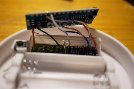

Step 6: Soldering
Keep all wires as short as possible. We will solder the wires first onto the MPU6050 and Voltage Booster Module then stick them from below into the Arduino and solder them on from above the Arduino. If the wires are too long, we won't be able to push the Arduino into its place.
Step 7: Soldering: Voltage Booster Module
Solder a red cable onto the Voltage Booster Module where the boosted voltage will come out.
Pic. 1: There! It's that round spot where the trace leads away to the resistor.
Step 8: Soldering: MPU6050
Now, solder four cables onto the MPU6050, one onto VIN, one onto SCL, one onto SDA and another onto INT. Keep them short.
Step 9: Soldering: Arduino
Have the red cable stick through VIN and the black cable stick through GND on the Arduino. Have the cables coming from SCL, SDA and INT stick through A5, A4 and D2, respectively.
Now solder them on from above.
Pic. 1: That looks about right. Maybe you can get those cables a bit shorter. It's a tight fit here, but it works. Fold them in carefully.

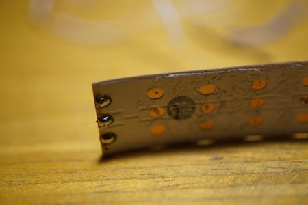

Step 10: Soldering: 32 Addressable LED Strip
Next, find that oval hole between the Arduino and the MPU6050. We'll use it to route the cables for the LED strip through it. But first, we'll prepare the LED strip.
Solder three spots onto the 32 addressable LED strip. Note the direction of the arrows on the strip and solder the spots on the right end. If the arrow points to the end of the strip, it's the wrong end.
Pic. 1: Solder the spots onto the back.
Place the LED strip around the inside of the fidget's top part. Start with the centre of the first LED at 9 o'clock and continue clockwise. 9 o'clock is where the oval hole is located.
Now, solder a red cable to +5V, a black cable to GND and a different coloured cable to D6 on the Arduino. Now, route them through that oval hole. Then solder them to Plus (+), DATA and Minus (-) on the LED strip, respectively; that is, the top most solder spot is Plus (+), the middle one is DATA and the lowest one is Minus (-).

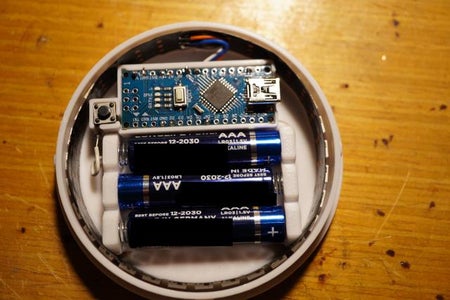

Pic. 1: All done. Batteries inserted.
You should all be set now. Have fun travelling our solar system.

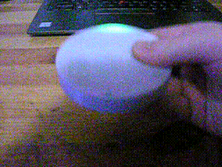

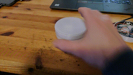

Pic. 1:To travel from planet to planet hold the fidget horizontally, turn it twice by 180 degrees. If there is no change, try doing it faster.
To turn the fidget on, turn the upper half clockwise. To turn it off, turn the upper half counter-clockwise.
