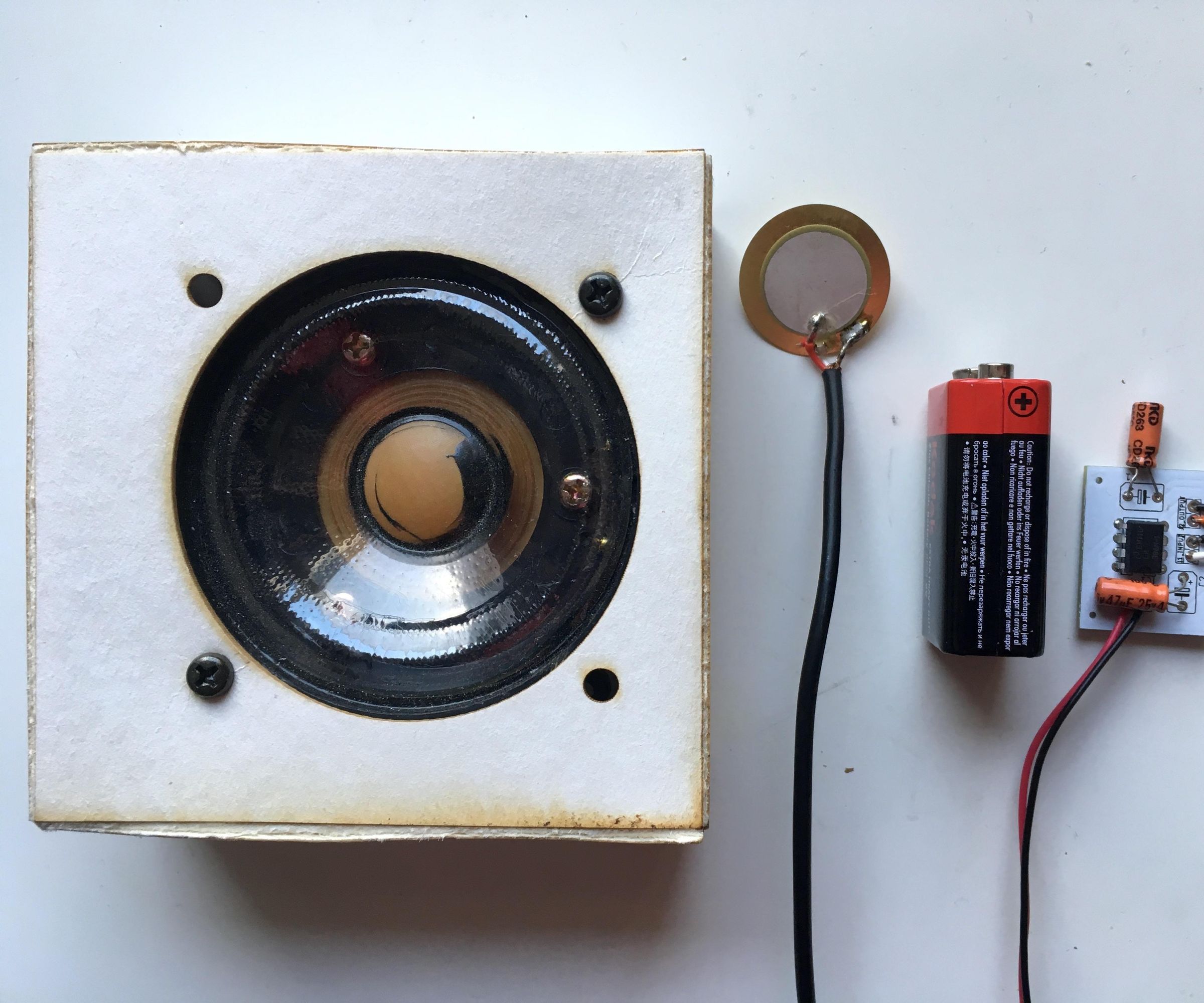

Build a 9 volt audio oscillator and amplifier which can be controlled with light.

Step 1: Breadboard DIY Electonic Musical Instrument Build
Using the illustration of the breadboard assemble the circuit.
Notice the orientation of the power connections (red = positive, black = negative),
also; ICs (N.B.: see pinout).
and capacitors.
See the second breadboard image which replaces the LDR with a pot.
Pots can be added in a number of positions to control gain, frequency and feedback.
