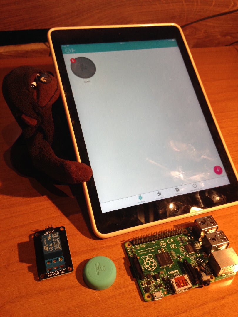

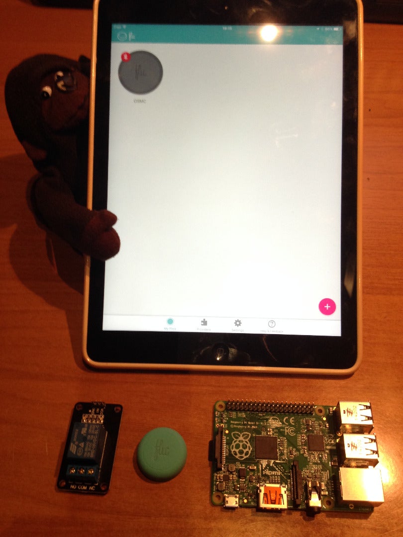

To perform the project you need:
hardware
Raspberry Pi B (at least) with PS RPi
Relay module Songle
Flic smart button
Smartphone or tablet
TV (*)
other specific hardware
PC power cable
PC extension power cable C13 C14 Female sockets
C13 & C14 Female panel mount plugs
A plastic box
Three jumpers

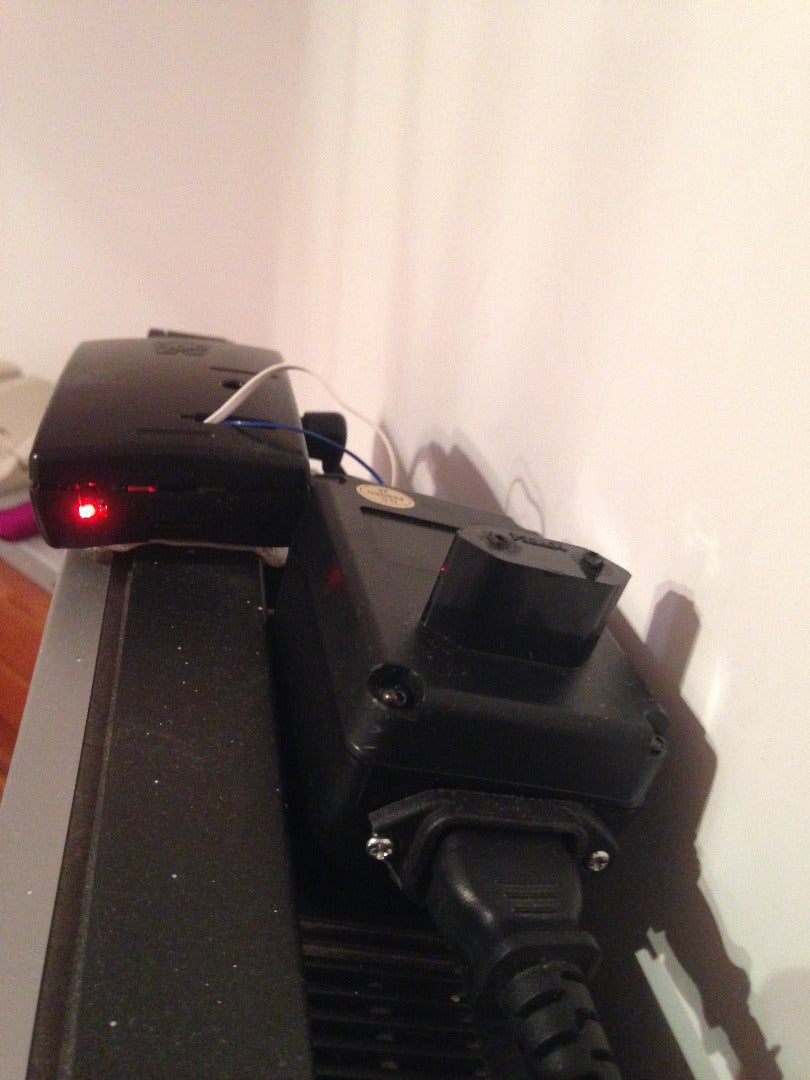

Step 4: Relay Box
My projects policy is: when possible, recycle .
Starting from a low voltage broken power supply i've recycled the enclosure box.
Two sockets come from a PC PSU.
Then with Dremel tool i've molded the plastic box.
Relay is screwed inside it and VCC and GND are connected respectively to PRi pin 2 and pin 9, relay SIG to pin 15.
Relay used was not exactly correct for my purpose.
When it is powered, NO contact closes and i'm not able to control it when is powered by 5V RPi pin . If i connect it to 3.3V RPi pin, i can control but, sometimes, it jams (*) and NO contacts remain closed.
Then "GPIO.setup(22, GPIO.OUT)" instruction inside script give power to relay and it close NO contact.
The only way to open NO contacts to turn TV off is to poweroff RPi. That's all what i need.
Weld three cables between sockets. Cut one of them (not the yellow cable, it's ground connection) and connect the two ends to NO and COM on relay module.
Be carefully when you connect all to 110/220V AC, don't touch nothing if don't want an high voltage electric shock .
Now you have only to connect two TV power cables to relay box then, once everything is connected plug to AC wall socket.
(*) I casually discovered that moving strong magnets around a jammed relay, sometimes it unlocks

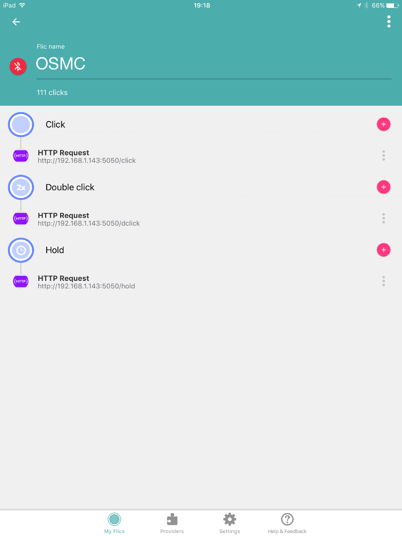

Step 5: Flic Smartphone App
Assuming that you have already paired you Flic button, for each button pressing add a HTTP GET requests (set "don't show response") with these features :
Click
http//YOUROSMCIPADDRESS:5050/click
Double Click
http//YOUROSMCIPADDRESS:5050/dclick
Hold
http//YOUROSMCIPADDRESS:5050/hold
