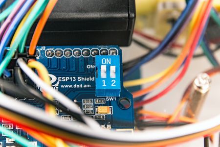

7) Insert OSOYOO Uart Wi-Fi shield V1.3 onto your board

Now hardware installation is almost down. Before we install 18650 batteries into the box, we need to burn the sample code into the board First.
