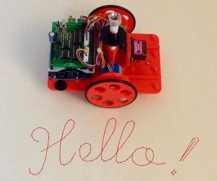

Introduction: Open Source Turtle Robot (OSTR)
Robotics is the exciting intersection of a number of engineering fields including mechanical engineering, electrical engineering, and computer science. This project was designed as the basis for a two-day workshop for high school age students to introduce them to engineering principles and giving them a jumping off point for exploring their interests further. There is something for everyone here, even if it is just for the art it creates.

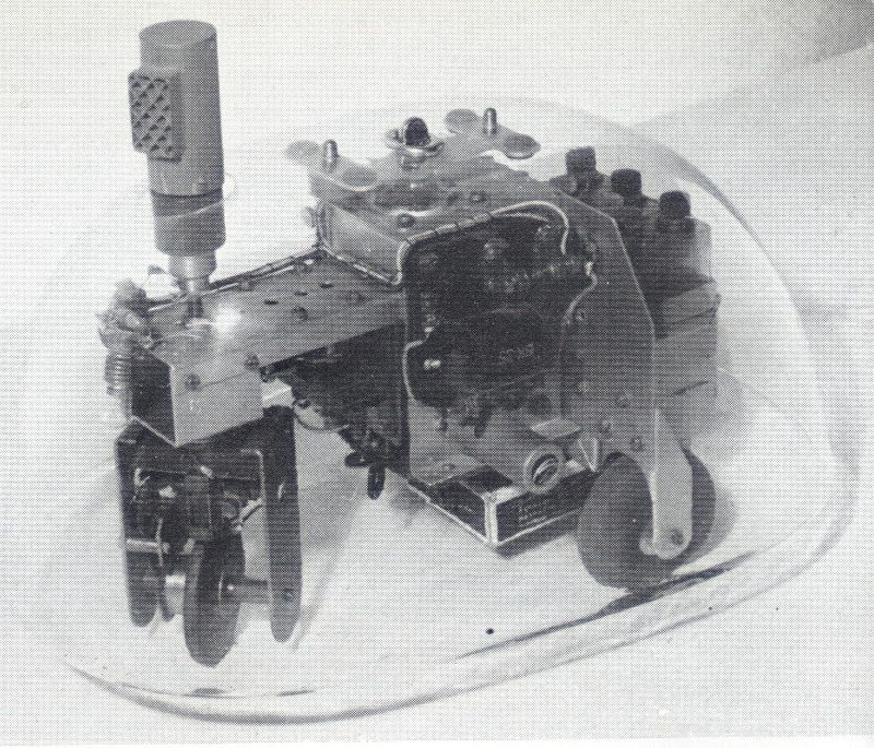

What is Turtle Robot? The concept can be traced back to William Walter’s robotics work in the 1940s which investigated complex behaviors in simple systems. Turtle robots are generally slow moving with tight turning radiuses and can trace a design that shows their behavior over time. They make excellent teaching aides in that their programmed output can be seen visually. A number of programming languages have “Turtle Graphics” built in. Turtle graphics can also be used to investigate advanced topics like L-systems or affine geometry
What is Open Source? If you can look past licences and lawyers, Open Source is a philosophy that ideas should be shared, and if you use an idea you attribute the originator, and if you improve on it, you should share your improvement. Every part of this project, from the circuit board to the 3D designs, are available for study, replicating, and improving. Not only that, but it was designed and programmed used Open Source programs like Arduino and KiCad. All you would have to do is use a computer running Linux (an Open Source operating system) and print the parts on a RepRap based 3D printer (an Open Source project), and you would have Open Source Turtles All the Way Down. This project is certified as Open Source Hardware by the OSHWA.
This project is just the latest iteration of my “Low-Cost, Arduino Compatible Robot”, which in turn is based on the work of others. The concept of two wheel drive with pen in the center is from the Mirobot. Improvements over the Arduino version include a printed circuit board for ease of construction and robustness, infrared sensors for obstacle detection, and a more compact and stiff chassis for more accurate movement and lower printing cost. Rewiring port assignments and firmware improvements help remove stuttering caused by Arduino’s digialWrite() inefficiencies.

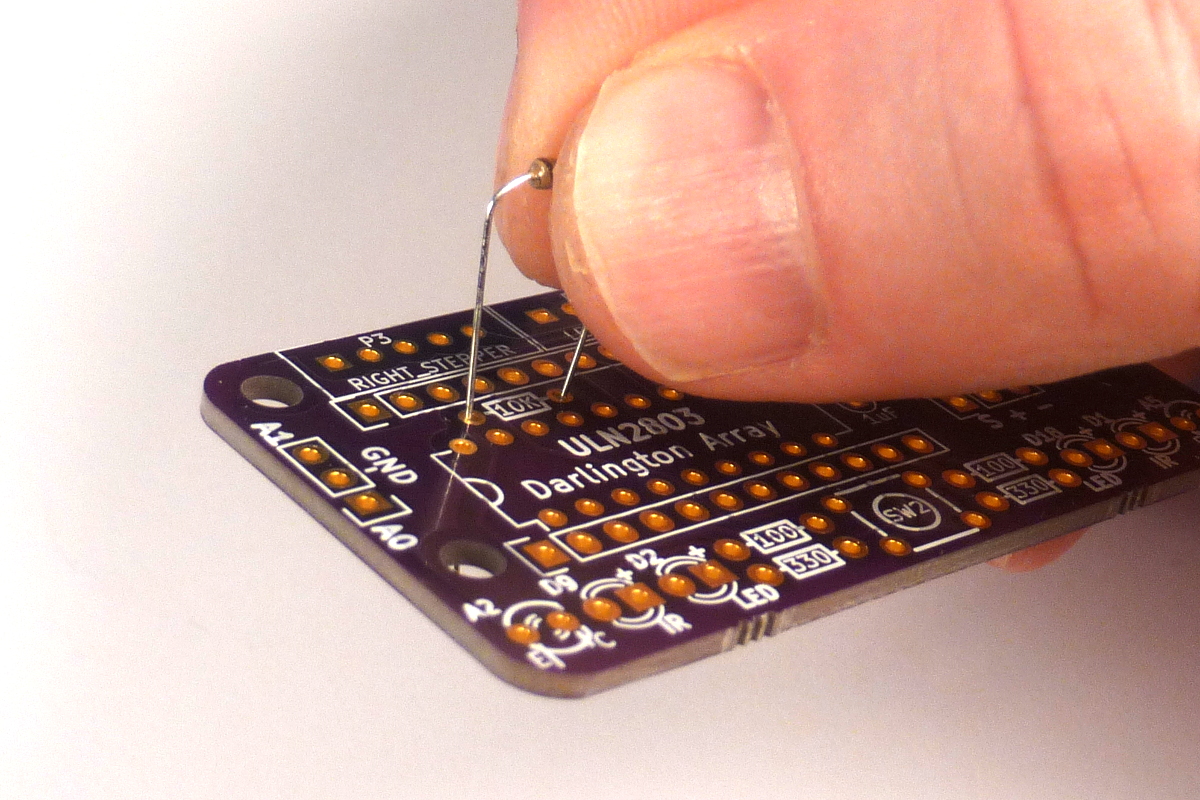

Step 4: EE: Resistance Is Essential.
I like starting with the resistor because:
- They are relatively heat resistant while you are getting into your soldering groove and the iron is coming up to temp,
- They have no polarity, so orientation is not critical, and
- They are the lowest component on the board so sit tight when soldering when the board is flipped on it's back.
Since these are our first components, we'll cover them a little more in depth starting out. There are three pairs of two different values:
- 10K ohm for sensors [brown - black - orange - gold]
- 330 ohm for LED current limiting [orange - orange -brown -gold]
Check out www.resistorguide.com/resistor-color-code/ if you want to
learn more about reading resistor color codes.

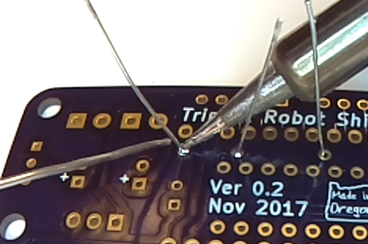

You can do one at a time, or all six at once.
- Bend the leads to the width of the pads and insert the resistor.
- Flip the board over and heat both the pad and lead for about two seconds.
- Introduce solder, and maintain heat until the solder melts and flows around the pad.
- Remove the solder, and then the heat, in that order.
- If your solder gets stuck, just re-heat the joint.
- Trim the leads with flush cuts.

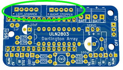

Step 9: EE: Headers & Terminals
The two stepper motors are connected using the white JST headers. They have two slot on one side that face outward. There is also a small locating pin that fits in a hole in the circuit board.
- Insert the header and verify it is seated correctly.
- Solder the pins in place.

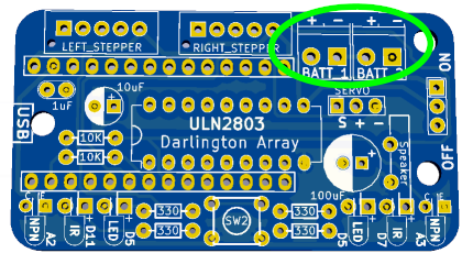

Power from the two battery holders are connected via the two black terminal headers. The openings face outward as well.
- Solder one pin from each terminal.
- Flip the board and verify the terminal is flat and openings facing out.
- Solder the remaining pin.

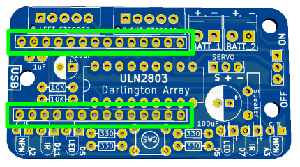

Step 13: EE: Brains
The Adafruit ItsyBitsy connects to the motor board via two 14-pin female headers.
- Cut the headers to length and insert them into the sockets with the short ends upward.
- Place the ItsyBitsy onto the pins.
- Ensure the the top (USB, microchip, and reset pin) are upward!
- USB connector toward the edge.

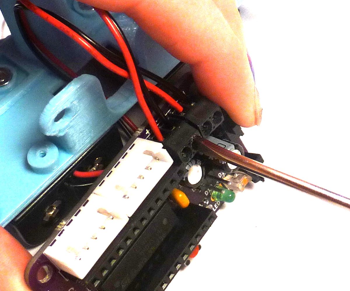

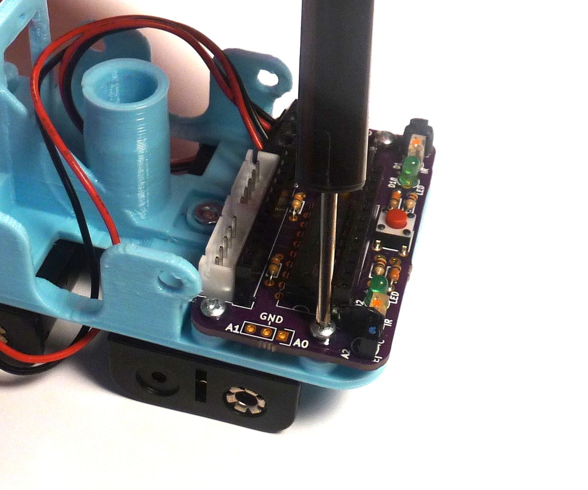

Step 17: ME: Batteries
Integrating the electrical components like motors and batteries with the chassis will fall into the ME's domain.
- Attach the battery holders using two M3 flat-head screws and thread the wires through the openings under the motor mounts.
- Put on your "EE" hat and attach the positive and negative wires to the terminals marked "+" and "-", one set of batteries for each terminal.
- Attach the circuit board to the chassis using #2x1/4 thread-forming screws.
- If the screws wont start, remove the PCB and use the tip of the screw driver to open them up a bit.

- Fold and press the wires into the cavities between the headers and the steppers to keep them clear of the servo arm during operation.
- Insert the Adafruit Trinket Pro into the headers with the USB hub facing the edge and press into place.
- Ensure the power switch is set to off.
- Insert the batteries.

No power when on-switch turned on:
- Ensure you have fresh batteries.
- Ensure batteries installed correctly.
- Double-check battery connections to terminal blocks.
- Disconnect servo & steppers.
- Use a volt meter to verify voltage at terminal blocks.

- You have the left and right steppers plugged in to the opposite headers.

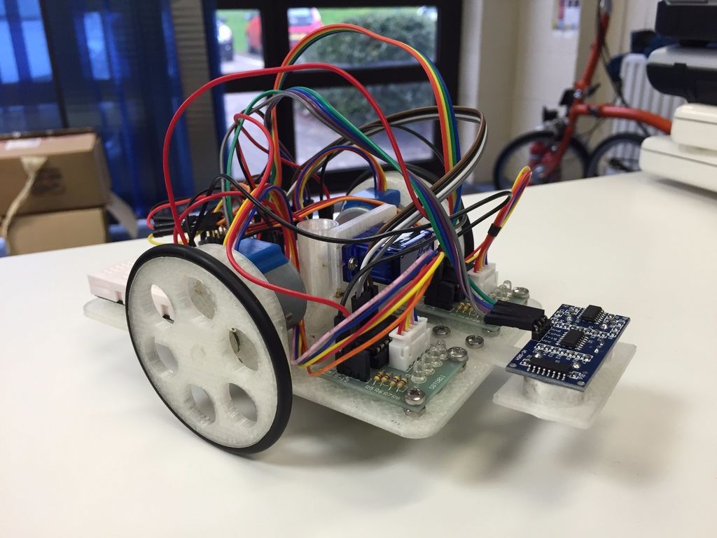

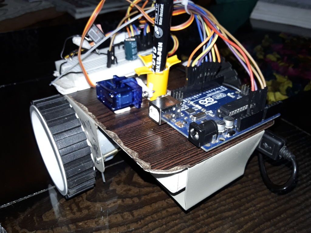

I love seeing these robots out in the wild, especially when they have been modified in ways I would have never have thought. Here are a couple of notable examples, with hopefully more to come:

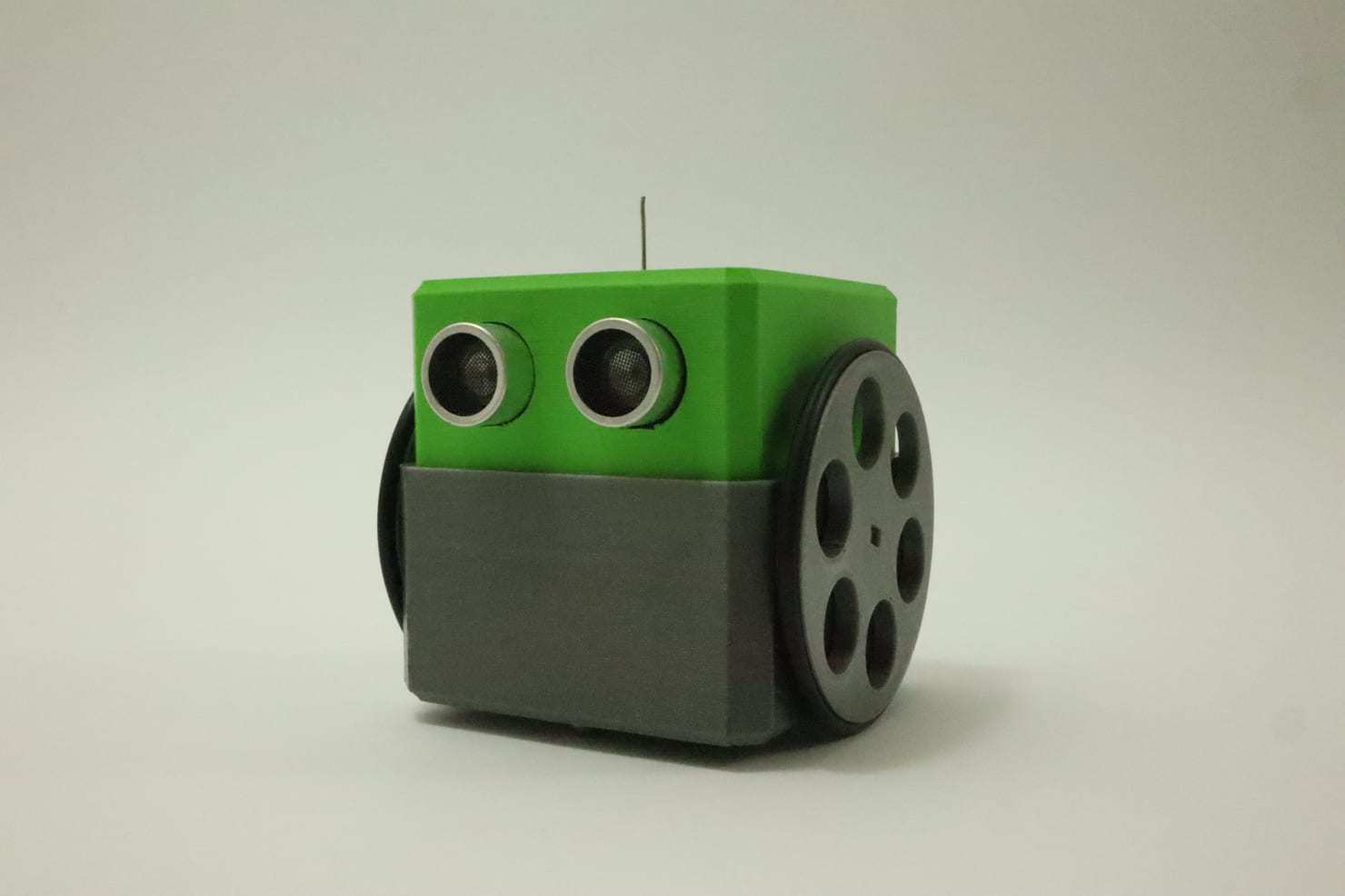

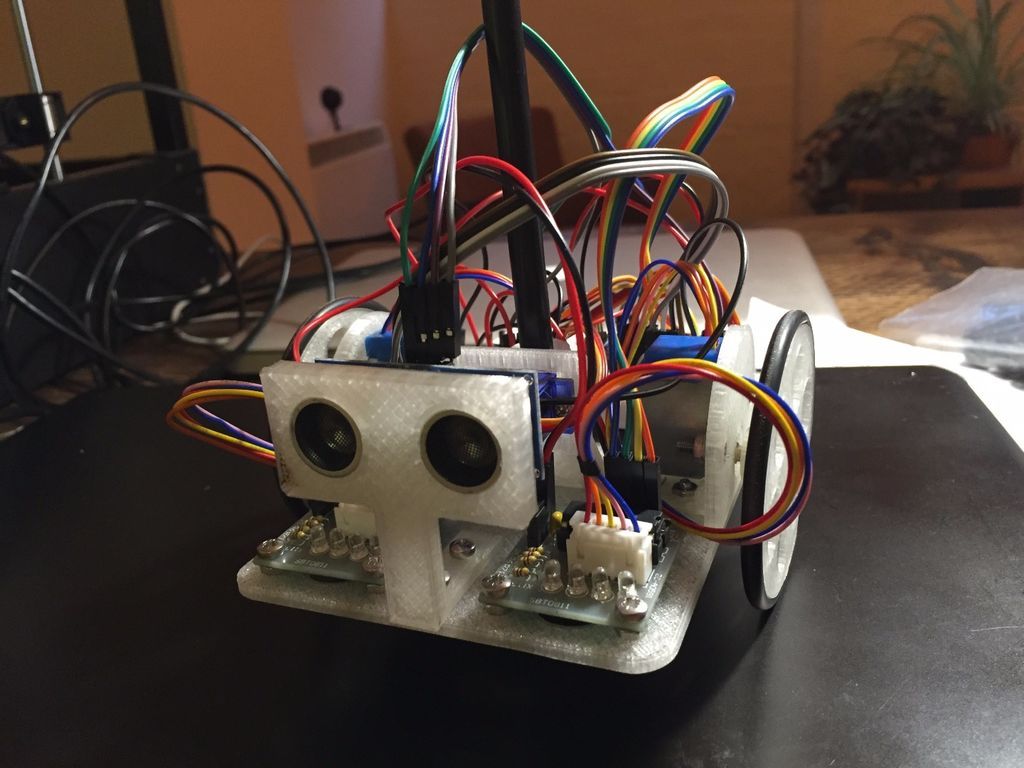

![]() | Instructable User Aaqup has taken the Turtle to the next level with his Otto Turtle Project! He was able to make it more compact by having the pen travel through the circuit board!![]() |
![]() | Russ Hughes does workshops and has created a custom circuit board, uses Tiny Basic, and has implemented the Hersey Vector Font. |
Instructable user seancuttlefish added both sonar and line following |
![]() | An in the "where there is a will, there is a way" category, Samarsis created a version with no 3D printing! |

I am trying to build an OSTR. In principle everything was fine until I tried to create the connections between components in my PCB. According to the files that I have obtained in your links it appears in one way and in the pdf tutorial of another. By the way, the ULNS803 solders it upside down by mistake. Does it influence anything? How can I solve the PCB? I attached photos of my progress.
Thanks in advance. I wait your answer.
Sincerely
Sergi Sánchez López.
Answer 1 year ago
I'm not a big fan of perf boards, but you should be able to get something to work. I think your best bet is to use the schematic to do the point-to-point wiring. I'm willing to send you a PCB if you'll cover shipping.

I am currently working with this scheme that I have made from those that come in the V2 folder.
(The scheme made on your PCB is wrong, I have made a couple of corrections. It is only to show you how I have done it.)
