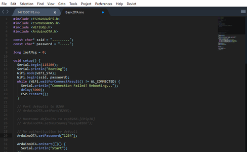

To start using OTA, first you need to upload a firmware to enable it. We will use the BasicOTA example to do that.
It's necessary to change this lines:
const char* ssid = ".........."; // Your wifi name
const char* password = ".........."; // Wifi password
Additionally if you want to protect you device with a password, uncomment and set your password in this line:
ArduinoOTA.setPassword("admin");Step 2: Upload Your Code

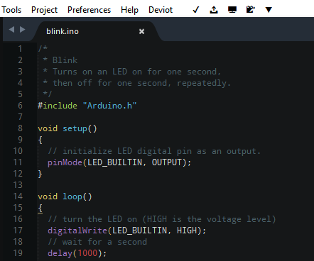

- Select a Board: Deviot Menu > Select Board and choose you board
Remember this feature is only available in ESP devices (full list with supported devices)
We can't use OTA to upload our code yet, so we have to select a Serial Port:
- Upload you code: Deviot Menu > Upload
You will be prompt to select a serial port, but if you have selected one previously, go to Deviot Menu > Serial Port(s) and select the right one.
You will see the percent of the upload, wait until it's completed
