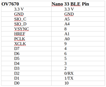

Connection between the Nano and OV7670 as shown in the table
Completing this connection is a little tricky and results in a tangle of wires. Picture included of the final connection.

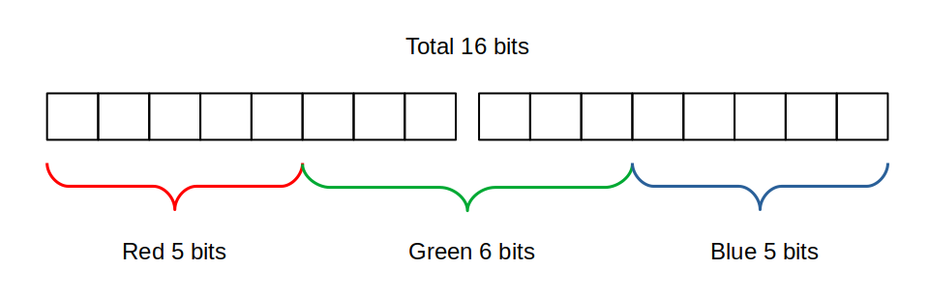

RGB565 uses a total of 16 bits as shown in the picture
reen is allocated 6 bits because the human eye is more sensitive to graduations in green than red or blue.

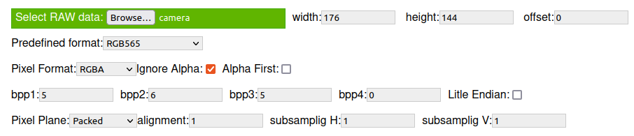

  8. Navigate to the website http://rawpixels.net in a browser
  9. Upload the file “camera”
Settings as follows:
width: 176
height: 144
offset: 0
Predefined Format: RGB565
Pixel Format: RGBA
Ignore Alpha checked
Little Endian not checked
