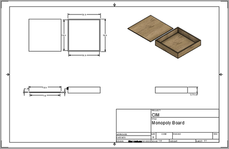

Step 1: Design
To get the best results you will want to design your idea in Fusion 360 to get a good idea of the necessary dimensions and materials you will want in your final product.

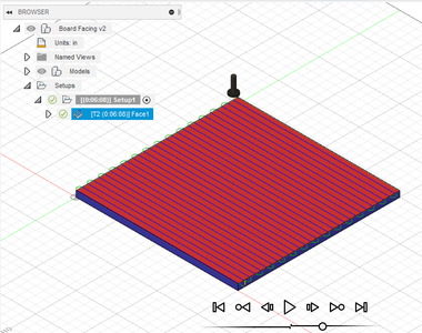

Step 7: CNC Facing
To get the top of the wood flat I used a CNC router to do a facing pass over the entire square and then lightly sanded it down with a handheld orbital sander.

Step 8: Cutting Sides for Box
I wanted to make a box for my board so I used a chop saw to cut 45 degree angles on a 3.5x19.5 inch piece of oak. These pieces need to be exactly the same size so you may want to grab an extra piece of wood in case you mess up.

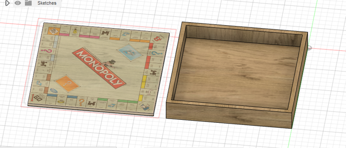

Step 12: Laser Engrave Board
To get the board onto the piece of wood I used a laser cutter and engraved the outlines of the board using an option from lightburn software. After that I se the origin to the desired location and made sure the board was square with the origin before I started the engraving which took about 10 minutes.
