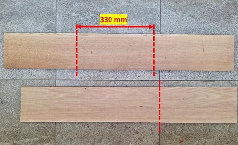

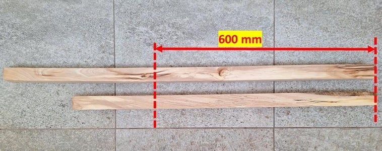

  • prisms - beech - 37 x 37 x 1000 mm – 4x
  • thin boards - oak - 150 x 8 x 1000 mm – 2x

The base platform is made of 4 segments of the thin oak boards glued together with 2 parallel beech prisms to support the weight. The prisms are cut to length of 600 mm and the oak bards to segments of around 330 mm (1 long board cut to 3 identical segments + 1 more segment from the next board).
The gluing is done by 1 segment at a time - first segment glued to 2 prisms, then 2nd segment glued to 1st and prisms, and so on, keeping eye on the paralellity of the 2 prisms and perpendicularity of the segments edges to the prisms edges (due to limited number of clamps). Titebond III glue was used since it's relly firm and I have good experience with it from the past
After the gluing, the whole part can be formetted on the table saw to nice rectangle with dimensions 600 x 315 mm according to the attached drawing.

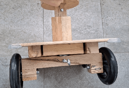

Regarding the front axle, we join the axle prism with the steering rod using M6 eye bolt, secured with nuts on both sides. On the rod, we place 2 M14 stainless washers. It's good to spray a bit of sillicon spray now on the mating surfaces of these washers to slide better. This whole unit is then inserted into the 15 mm hole in the main platform and steering column. We place the steering wheel from the top side and secure it with M5 screw. On this, the precision of how we drilled the holes is verified, but in my case, the screws went through with some slight resistance, which was a benefit in the end so there was not much clearance in the steering.
Subsequently, we put on the wheels - we separate the M8 bolt with 1 washer from the outer side, 2 washers in between to separate it a bit from the axle side and finally 1 washer from the inside underneath the nut.
Additionally, 2 M5x60 screws were added into the base flatform's prisms from the botoom side as a means to stop the turning of the front axle when the limit is reached. After screwing in, the head of the bolt was cut off. They were coated with spare electrical cable protection for a bit of damping when the axle bumps into the stop.

The other free end of the rope is tied with the carabiner, which is connected with the eye bolt on the front axle. Pulling the cart by the rope connected with the front axle at the same time gently guides the front axle and the sttering wheel in the correct direction and teaches the child in which direction it is needed to turn the steering wheel.

After some usage, the vehicle left some damage marks on our walls when the kids bumped into the wall, so I pasted 4 silicone corner protectors on the base platform not to destroy our home.
