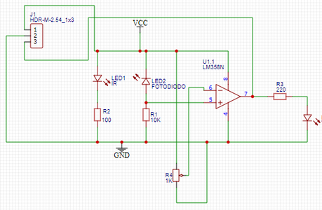

Step 1: Connecting the Infrared Emitter
The emitter looks just like a normal clear LED but once connected, you can only see the infrared using a normal camera such as a phone camera.
The connection is as shown above.
Step 2: Infrared Receiver / PhotoTransistor
It looks like a normal LED physically, but is black in colour.
Step 3: PhotoTransistor Connection
Connect the IR Receiver as shown on the breadboard and align the Emitter and the Receiver.
Make sure there is some space between them.
Connect the output to analog pin A0.
