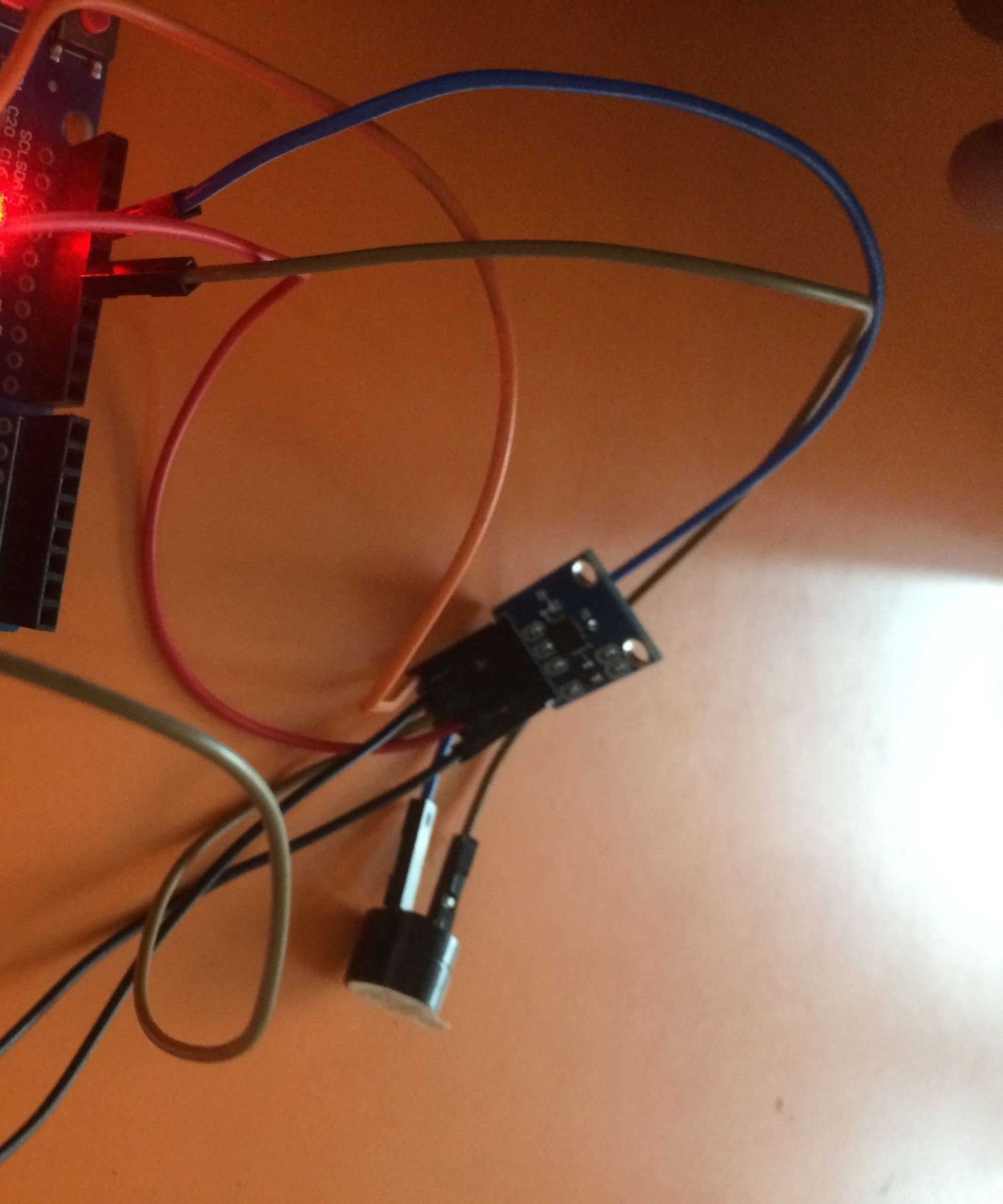

Step 5: Connecting the Arduino to the L239D
Here we must use four male to female wires to do this. First connect 2 wires on the input side of each motor. We must then connect these to the digital pins which we inserted in our code(ex;-11, 10, 9, and 8). Each wire should be connected to the pin number which was assigned to them. After this is completed we must attach the battery connector to the L239D, where the positive pin is to ground and the negative pin to 9 volts. Then we must us another male to female wire and connect the 5 volts pin in the L239D to the 5 volts pin in the Arduino.
Step 6: Connecting the Arduino to the IR Sensor
Now for the final part of the project we must use three male to female wires. First connect one wire from the VCC in the IR sensor to the 5 volts pin in the Arduino. Next connect the ground pin to the ground pin in the Arduino, and finally connect the output pin to the digital pin which was assigned in the code.
