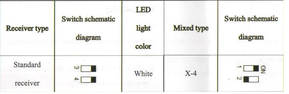

Set Quad copter flight controller as given instruction.
Once you connect all wire of ESC, Motors etc. with the QQ Thunder. Do not Connect propeller right now.
Connect ESC and Reciver.
- Connect receiver 3rd Channel to THR channel of QQ Thunder.
- Connect Receiver 4th channel Signal pin to R. channel of QQ Thunder.
Connect Receiver 1st channel Signal pin to A. channel of QQ Thunder.
Connect Receiver 2nd channel Signal pin to E. channel of QQ Thunder.
Diagram Image is there check from it.

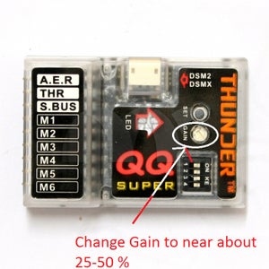

set gain port in between 25% to 50%. for beginner. Later on you can change it as per your requirement.

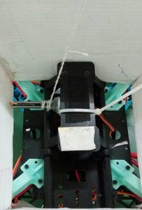

Step 4: Fitting Servo
Put servo as per Image. And also put thread around wood and fix its one end with storage box gate & other one with servo shaft.
