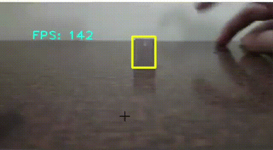

Above is the Demonstration of the heatsink being tracked with a good accuracy and average speed of 91 FPS

HURRAY we have created an object tracking program
Step 6: Analysis of All Trackers
CSRT - accurate | average FPS-7
MIL - accurate | average FPS-3
KCF - very less accurate | average FPS-44
MOSSE - accurate(depends on video conditions) | average FPS-91 best ONE(For my case)
Boosting - less accurate | average FPS-14
Median Flow - less accurate | average FPS-62
TLD - very less accurate | average FPS-5
