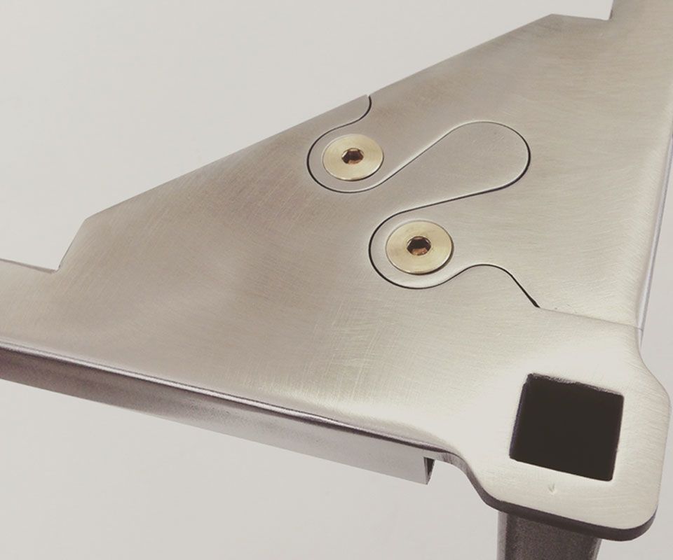

In fact, the detailing of the joints is perhaps only possible with the capabilities of a 5-axis water-jet cutter. The intersection between each leg and the neighboring brace results in an oblique condition which is reconciled with a through-tenon joint. Five-axis cutting allows for an integral shoulder and a flush detail all from one single operation. Furthermore, the pin which ties the joint together (in this case a flat head cap screw) intersects adjacent parts at another oblique angle (limited by the maximum tilt of the water-jet head) and results in an elliptical (or conic-section) countersink - an operation that would be difficult if not impossible with traditional means.

Eventually through trial and error of manual modeling I came to a configuration which seemed simple yet sophisticated in terms of overall form as well as details. An oblique through tenon at the leg / brace intersection 'pinned' together with a flat head cap screw and a through tenon at the leg/seat with flat head cap screw / allen nut to tension the joint both seemed like clean ways to assemble the stool.

Testing the exported.step files in Intellicam however revealed that some of the cutting angles were too steep for the head tilt! This was great - the design was pushing the capabilities of the machine. On further investigation, I found that the max tilt angle was 59.9 degrees - the intersection between the cap screw and the leg brace produced a 60 degree cut (.1 degrees too steep)!!
One solution would have been to adjust the angle of the 'pin' cap screw by the very small (perhaps unnoticeable) amount. This could however come across as a mistake. Instead i decided to express the angle further and by doing so leverage the unique capabilities of a 5-axis waterjet - taking what could normally be done by hand (a countersink into a surface at a perpendicular 90 degree angle) and tilting the angle of that countersink to the point where it would be virtually impossible to do manually. I feel the resultant elliptical cutout to be a beautiful expression of machining process.

If your settings are correct, the waterjet leaves perfectly square, if not slightly sharp edges. I eased all the edges first by hand with various files. I tapped the steeply angled holes by hand while holding the workpiece in a vise. Then on the seat part, I used a small edge trimmer with a 1/16" round over bit to radius the edges for a softer feel. Lastly I used a random orbital sander with 220 grit to give the surfaces a consistent finish prep before taking the pieces to the anodizer.
I chose a 'bronze' anodized finish to highlight the brass hardware I planned to use. After getting the parts back, assembly took a minute or two.
