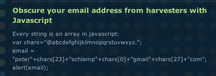

Harvesters are just programs written in a way to capture your email address on a webpage. We can write a very simple program to confuse them.
We must create a string of characters that will represent the letters and symbols in our email address. We could also use one for email addresses that incorporate numbers and other symbols, but for simplicity of this tutorial I will only be showing you one for very basic email addresses that have only letters:
var chars="@abcdefghijklmnopqrstuvwxyz."; // for very simple email addresses that contain only letters
Next we create a variable that will hold our actual email address that we want to output to the webpage:
var email = "peter"+chars[23]+"schlamp"+chars[0]+"gmail"+chars[27]+"com";
Every string in javascript is also an array. So if I wanted to grab a single character from my chars variable above, I could do so by referencing the index of my chars array like so chars[1], which is associated to "a". Because javascript array indexes start at the number 0, if I reference chars[0], I will get back the character "@" from the chars array. I set my chars array above in a way that if I want to reference the 1st letter of the alphabet, "a", I would call chars[1], and if I want to reference the 26th letter, "z", I would call chars[26]. So, the email variable (above) references my entire email address by chaining together real strings like "peter" and calls to my chars array.
alert(email);  // outputs my email address in an alert box
The next step will show all the code together and a way to output it on your page.
