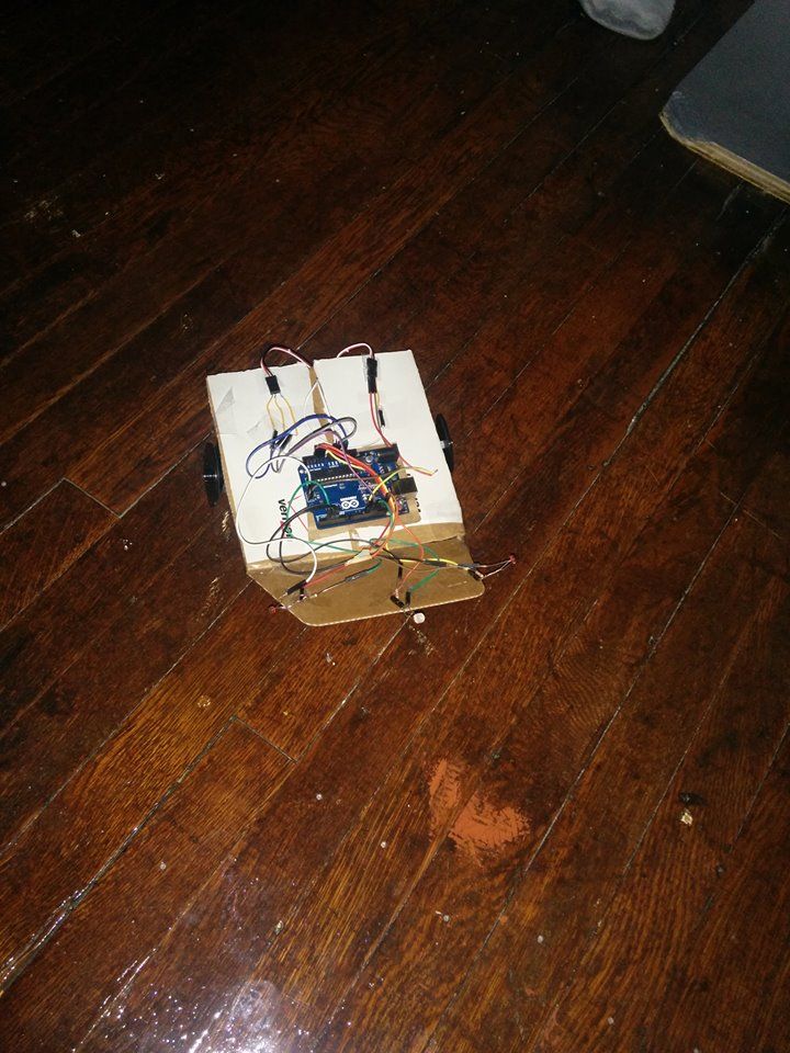

All right, so i decided to make a robot with a relay board. I have never used a relay board in my life and this was the first time i was working with it. First i thought it would be really complicated but it turned out not to be. I used fairly simple tools and if you follow this, i'm sure that you'll be able to make this robot in less then an hour.

Step 1:
First, you use a box or something that you could use as the body of the robot. In this case, i have used a simple white box to make it appealing. It could be any box, but remember it should be able to carry the weight of the materials.
Then, fix the motors in a proper place, you could also put a clamp to hold the motor as i did, or you could use something else to support the motor and gears.
After fixing the motors, i placed the relay board and the arduino uno board on top of the robot, but you may place them in a location of your choice.
Step 2:
After placing the arduino uno board, i placed the hc-sro4 sensor.
Once you have everything in the place of your choice, you need to start connecting the wires.
First, connect the arduino uno board to the relay board with wires.
Gnd goes to the gnd and vcc goes to the vcc pin of the arduino. Pin2 of the relay goes to 7 and pin4 of the relay goes to pin9.
For hc-sro4 sensor, gnd pin goes to gnd, vcc pin goes to vcc, eco pin goes to pin2, and trig pin goes to pin3.
Now you can connect the battery wire and motor wires to the relay board, and also use the 9v battery power to power the arduino.
