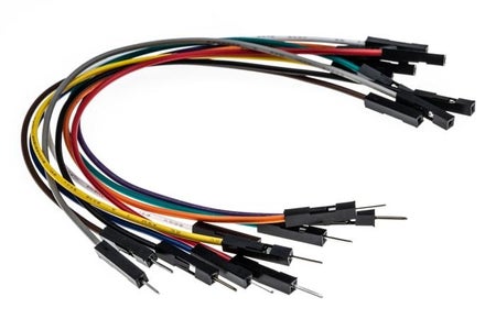

-Jumper wires (male to male)
-Jumper wires (male to female)

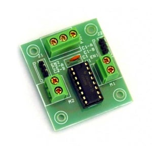

-Motor Driver

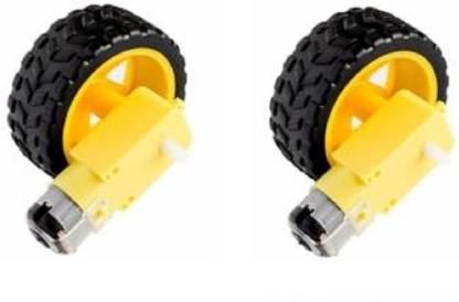

- Hobby motor and wheels

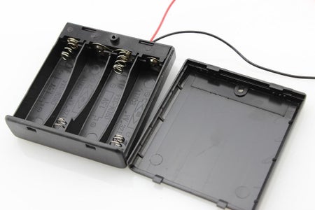

-AA battery holder

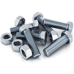

-Nuts and Bolts

Step 2: Attach the Legs to Chasis
Attach the legs of our robot i.e. motors to the chasis by nuts and bolts and attach the wheels to the motor.

Step 5: Attaching Motor Driver to Chasis
Now we will attach a motor driver behind the arduino using 2 nuts and bolts by connecting them diagonally as we did in the case of arduino.
Step 6: Giving the Robot Its Power Source
We will use a 4 batteries AA battery holder to be used as the power source of our robot which would be connected to the robot by a double sided tape.
