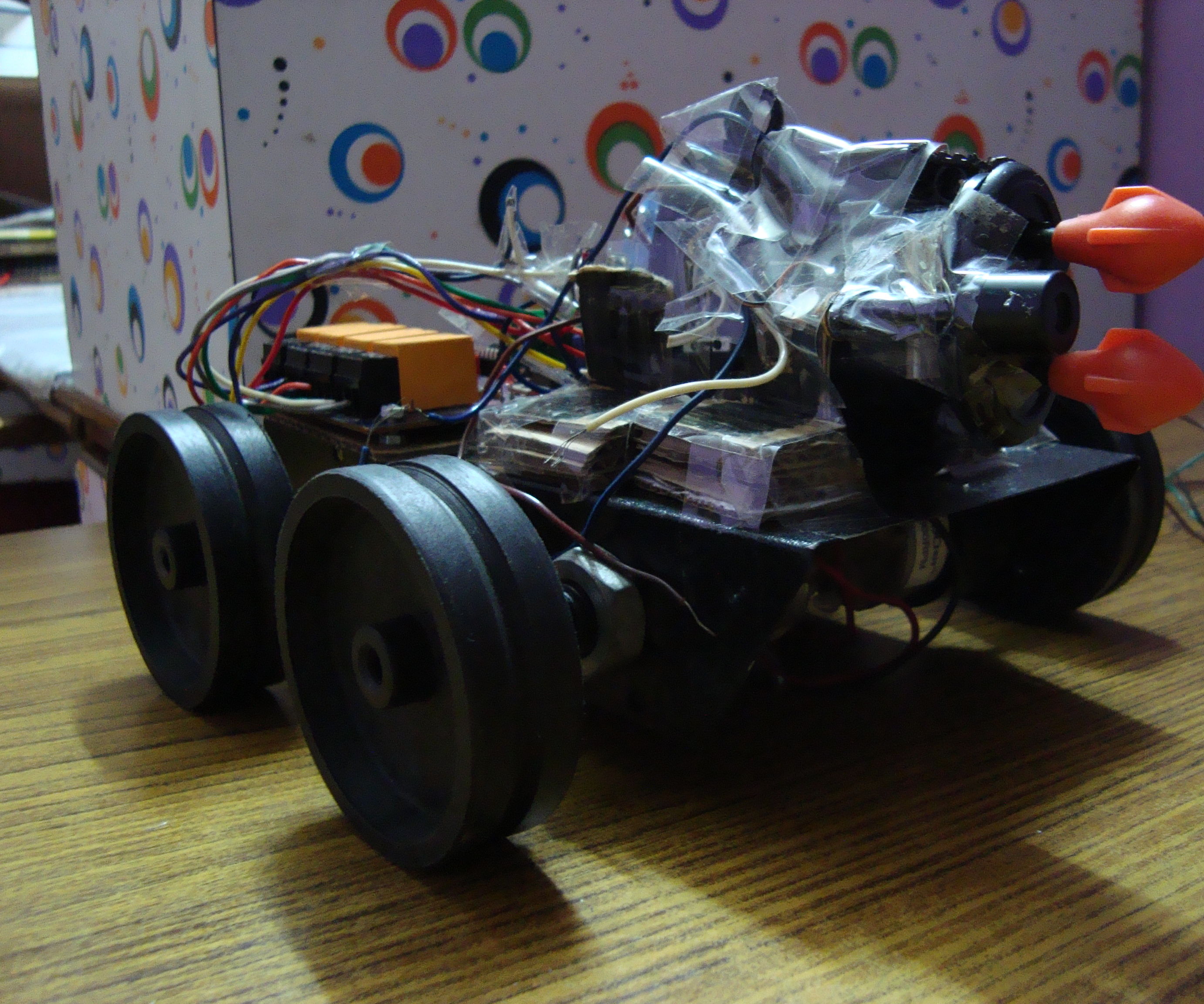

Step 3: Complete the Body
You will need all the remaining parts to complete this step.
Please ignore the 4 x 1.5 V DC cells and the battery holder shown in the pictures. Use the 9V DC supply. I supplied 6 V earlier and found that it is insufficient. The motors were running too slow on that power supply.
Make the Gearbox:
  • Screw the 4 L-Shaped Clamps in position as shown in the pictures.
  • Pass the axles halfway and do not pass them through the other hole.
  • Insert stopper and the wheel in the hind axle.
  • Insert the final driver gear first.
  • Next, Insert the intermediate transmission gears. Refer to the pictures for exact gear arrangement (The green and red gear).
  • Now, pass the axle to which, the wheel is connected through the other wheel after placing the second stopper in the right position.
  • Insert the driver gear, the stopper in the front axle and pass the axle through the other hole.
  • Place the stopper in the right position.
Complete the remaining body:
  • Screw the U-shaped clamp, the motor holder and the hex-rods.
  • Place the motor in their holders.
  • Attach the pinions to the motor shafts.
  • Insert the switch in its place.
  • The hex-rods are the Arduino Board's supporters. Screw the Arduino board on the rods.
  • Insert the Castor ball in the front hole.

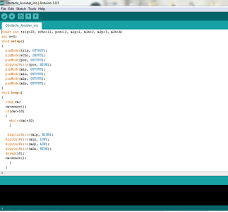

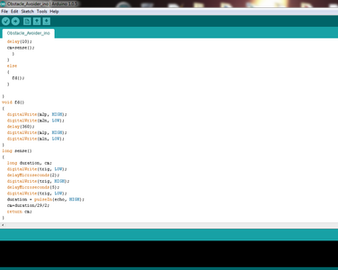

Step 4: Upload the Code
This is the code you need to upload to the Arduino UNO Board.
const int trig=10, echo=11, pos=12, m1p=1, m1n=2, m2p=3, m2n=4;
int x=0;
void setup()
  pinMode(trig, OUTPUT);
  pinMode(echo, INPUT);
  pinMode(pos, OUTPUT);
  digitalWrite(pos, HIGH);
  pinMode(m1p, OUTPUT);
  pinMode(m1n, OUTPUT);
  pinMode(m2p, OUTPUT);
  pinMode(m2n, OUTPUT);
void loop()
  long cm;
  cm=sense();
  if(cm<=10)
    while(cm<=10)           //this loop will keep turning the robot while there is an obstruction
  digitalWrite(m1p, HIGH); // to
  digitalWrite(m1n, LOW);  //   turn
  digitalWrite(m2p, LOW);  //       the
  digitalWrite(m2n, HIGH); //          robot
  cm=sense();
  else
    fd();
void fd()
  digitalWrite(m2p, HIGH);
  digitalWrite(m2n, LOW);
long sense()
  long duration, cm;
  digitalWrite(trig, LOW);
  delayMicroseconds(2);
  digitalWrite(trig, HIGH);        // send the ultrasonic pulse
  delayMicroseconds(5);
  duration = pulseIn(echo, HIGH);  // store the reading
  cm=duration/29/2;                // converting the reading into centimeters
  return cm;
}<br>
Now, you must be wanting to know what does the code really do?
  • First, the robot senses and manipulates sensor data to get the distance between the obstruction and the robot.
  • If the distance is greater than 10 cm, it moves forward.
  • If not, the robot turns. While it is turning, it still senses and when the favorable distance between the obstruction and the robot, i.e., greater than 10 cm, is found, the robot again starts to move forward.
You can refer to the Arduino website: Arduino - Home to solve any troubleshooting problems.
A common error is : avrdude stk500_getsync(): not in sync resp=0x30
This is due to mismatching COM port or driver is not installed/updated.
Sometimes, removing all loads/connections to the Arduino Board pins and then uploading the code as well as re-connecting the Arduino to the computer solves the problem.
