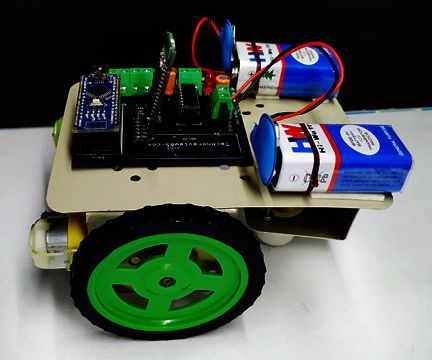

Step 2: Assembling the Root Chassis
Insert two geared motor in robot chassis. i have used a 2wd metal chassis but you can use any chassis
insert one castor wheel in front of robot chassis.the mechanical part is completed of this robot

Circuit & connections if you are using a perfboard
Here I used an Arduino nano & L293D dual motor driver. Two capacitors as a filter. Led & 1k resistor for indication
Arduino digital pin 7 connect to the ultrasonic sensor trigger pin
Arduino digital pin 8 connect to the ultrasonic sensor Echo pin
Arduino digital pin 5 & 6 connect to Ic l293d pin 10 & 15 for the left motor control
Arduino digital pin 11 & 12 Connect to ic l293d pin 2 & 7 for the right motor control
Connect left motor to ic l293d pin 11&14
Connect the right motor to ic l293d Pin 3 & 6

I have used a 9v battery for Arduino & another 9v battery for motor power.
For powering the motor it is good to use a rechargeable battery otherwise the 9 v battery can't run the robot long time.
