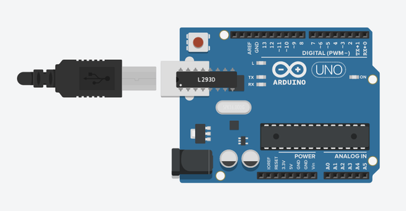

Step 3: Make the Connections
After you finish dragging the components start making the connections you can refer to the figure for convenience
Step 1: Place the L293D using the dip rail in the breadboard(see fig).
Step 2: Connect 5V from the Arduino UNO to the positive power rail.
Step 3: Connect GND from Arduino UNO to the negative power rail.
Step 4: Interconnect the power rails on both sides with their respective rail.
Step 5: Connect Enable 1,2; Power 1, Enable 3,4; and Power 2 to the positive power rails.
Step 6: Connect all the GNDs of the L293D to the negative power rails.
Step 7: Connect Trigger and Echo pin of the Ultrasonic Sensor to pin number 2 and 3 of the Arduino UNO respectively.
Step 8: Connect VCC pin of Ultrasonic to positive power rail and GND pin of the Ultrasonic sensor to negative power rail.
Step 9: Connect Input 1,2,3,4 of L293D to pin number 4,5,6,7 of the Arduino UNO.
Step 10: Connect output 1 of L293D to positive terminal of left motor and output 2 of L293D to negative terminal of left motor.
Step 11: Connect output 3 and 4 of L293D to negative and positive terminal of motor respectively.
Good job! your connection is finished you van move on to next slide.

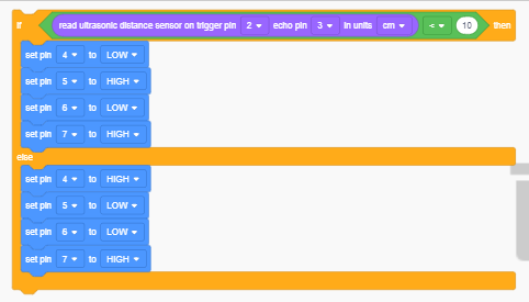

Step 4: Code
Click on the code button to Code you can either block coding or text coding depending on your knowledge of C++ programming.
To code using blocks you can refer to the above image.
To code using text you can refer to the code below:
// C++ code
// long readUltrasonicDistance(int triggerPin, int echoPin) {
pinMode(triggerPin, OUTPUT);
// Clear the trigger digitalWrite(triggerPin, LOW); delayMicroseconds(2);
// Sets the trigger pin to HIGH state for 10 microseconds digitalWrite(triggerPin, HIGH);
delayMicroseconds(10); digitalWrite(triggerPin, LOW); pinMode(echoPin, INPUT);
// Reads the echo pin, and returns the sound wave travel time in microseconds return pulseIn(echoPin, HIGH);
void setup() {
pinMode(4, OUTPUT);
pinMode(5, OUTPUT);
pinMode(6, OUTPUT);
pinMode(7, OUTPUT);
void loop() {
if (0.01723 * readUltrasonicDistance(2, 3) < 10) {
digitalWrite(4, LOW);
digitalWrite(5, HIGH);
digitalWrite(6, LOW);
digitalWrite(7, HIGH);
} else {
digitalWrite(4, HIGH);
digitalWrite(5, LOW);
delay(10);
// Delay a little bit to improve simulation performance
