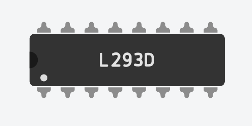

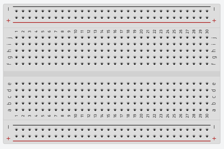

Step 1: Virtual Components
All these components will be found in the menu of the TinkerCAD circuits. The needed components are:
  1. Breadboard No. 1
  2. Hobby Motor No. 2
  3. Arduino UNO R3 No. 1
  4. L293D (Motor- Driver) No.1
  5. Ultrasonic sensor sensor No.1
Just drag the components from the menu and drop them in the work area.
