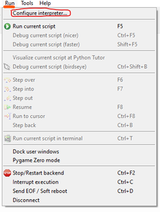

This setup requires switching the interpreter to 'Micropython (Raspberry Pi Pico)' on your IDE. In Thonny, it comes under the 'Run' tab in 'Configure Interpreter'.

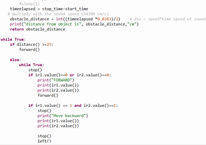

Step 5: The Code
This is a fairly simple code which involves an integration of Ultrasonic Sensor code, followed by the Infrared Code, and instructions for the car in each of the permutations.

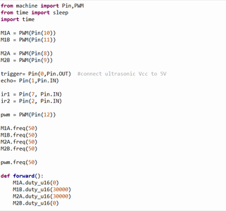

from machine import Pin,PWM
from time import sleep
import time
M1A = PWM(Pin(10))
M1B = PWM(Pin(11))
M2A = PWM(Pin(8))
M2B = PWM(Pin(9))
trigger= Pin(0,Pin.OUT)  #connect ultrasonic Vcc to 5V
echo= Pin(1,Pin.IN)
ir1 = Pin(7, Pin.IN)
ir2 = Pin(2, Pin.IN)
pwm = PWM(Pin(12))
M1A.freq(50)
M1B.freq(50)
M2A.freq(50)
M2B.freq(50)
pwm.freq(50)
def forward():

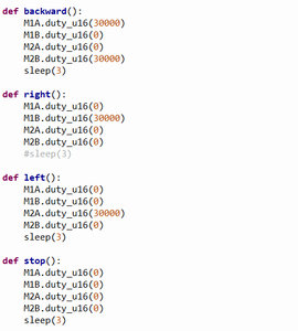

def backward():
    M1A.duty_u16(30000)
    M1B.duty_u16(0)
    M2A.duty_u16(0)
    M2B.duty_u16(30000)
    sleep(3)
def right():
    M1A.duty_u16(0)
    M1B.duty_u16(30000)
    M2A.duty_u16(0)
    M2B.duty_u16(0)
    #sleep(3)
def left():
    M1A.duty_u16(0)
    M1B.duty_u16(0)
    M2A.duty_u16(30000)
    M2B.duty_u16(0)
    sleep(3)
def stop():
    M1A.duty_u16(0)
    M1B.duty_u16(0)
    M2A.duty_u16(0)
    M2B.duty_u16(0)
    sleep(3)

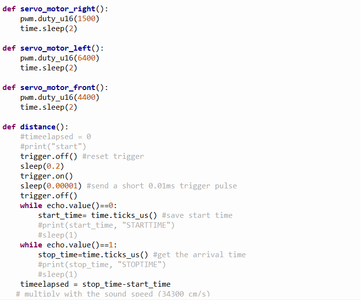

def servo_motor_right():
    pwm.duty_u16(1500)
    time.sleep(2)
def servo_motor_left():
    pwm.duty_u16(6400)
    time.sleep(2)
def servo_motor_front():
    pwm.duty_u16(4400)
    time.sleep(2)
def distance():
    #timeelapsed = 0
    #print("start")
    trigger.off() #reset trigger
    sleep(0.2)
    trigger.on()
    sleep(0.00001) #send a short 0.01ms trigger pulse
    trigger.off()
    while echo.value()==0:
        start_time= time.ticks_us() #save start time
        #print(start_time, "STARTTIME")
        #sleep(1)
    while echo.value()==1:
        stop_time=time.ticks_us() #get the arrival time
        #print(stop_time, "STOPTIME")
        #sleep(1)
    timeelapsed = stop_time-start_time
   # multiply with the sound speed (34300 cm/s)
    obstacle_distance = int((timeelapsed *0.0343)/2)    # dis = speed*time speed of sound=343.2m/s  . divide by 2 as we half the distance echo travelled
    print("distance from object is", obstacle_distance,"cm")
    return obstacle_distance

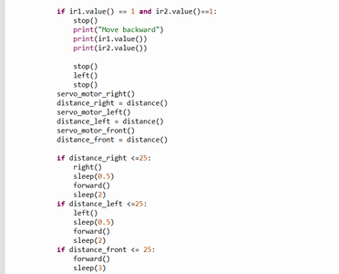

while True:
    if distance() >=25:
        forward()
    else:
        while True:
            stop()
            if ir1.value()==0 or ir2.value()==0:
                print("FORWARD")
                print(ir1.value())
                print(ir2.value())
                forward()
            if ir1.value() == 1 and ir2.value()==1:
                stop()
                print("Move backward")
                print(ir1.value())
                print(ir2.value())
                stop()
                left()
                stop()
            servo_motor_right()
            distance_right = distance()
            servo_motor_left()
            distance_left = distance()
            servo_motor_front()
            distance_front = distance()
            if distance_right <=25:
                right()
                sleep(0.5)
                forward()
                sleep(2)
            if distance_left <=25:
                left()
                sleep(0.5)
                forward()
                sleep(2)
            if distance_front <= 25:
                forward()
                sleep(3)

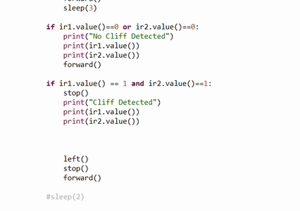

                print("No Cliff Detected")
                print(ir1.value())
                print(ir2.value())
                forward()
                stop()
                print("Cliff Detected")
                print(ir1.value())
                print(ir2.value())
                left()
                stop()
                forward()
            #sleep(2)
