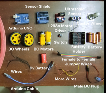

Step 1: Components.
I used my previous project's shield and ultrasound sensor in this project.
Learn how to make the Radar from HERE! The build is explained there.
The base for the whole build is an old HDD lid. It is light weight and it hold's its shape well.
The wheels are just from an old toy car.
Two servos for the wheels is needed and one servo for the radar.
And of course some kind of Arduino based board is needed. I used Intel Edison+ Arduino breakout board.
