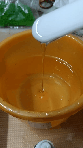

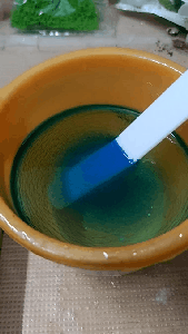

Using resin calculator available calculated required amount of resin, planned to do it in three stages, so first part mixed 200ml resin with 100ml hardener as its 2:1 ratio resin, so total 300 ml. 1/3 portion of requirement. Mix resin and hardener until its crystal clear with some bubbles, add few drops Blue alcohol ink or transparent pigment mix well, No of drops is totally based on your satisfaction of colour
Step 10: Pourrrr

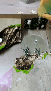

Once you have combined, do not wait start pouring as minutes goes by more heat will be generating within itself as exothermic reaction and it goes to string consistency very fast. Since the shells and stones are already struck in UV resin, put the star fish in place you want and leave it to cure
Step 11: Pour 2

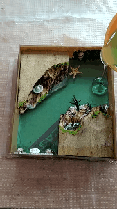

oops the first starfish has drifted apart from the place it put, some times with mobility object move before the resin cures. since it saw next morning after 8 hours, I can't do anything to put back to original position. Resin gets fully cured in 24 hours, 8 hours for surface cure. so for second pour again mix 300ml of resin & Hardener combination, pour and keep the bottom starfish
Step 12: Pour 3
so this time, 2nd starfish gave a surprise with mini bubbles. Mix the resin and hardener after 8hours and do the third pouring, make sure to get in the nuke and corner of setup especially side walls of wood.

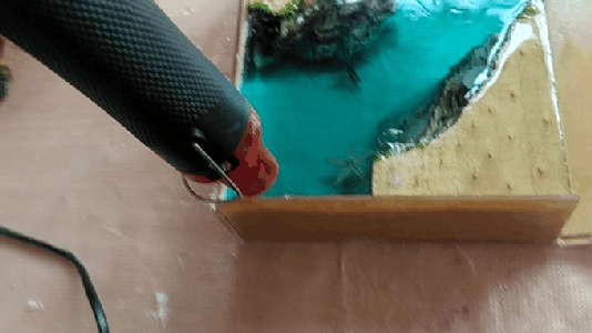

All the pour done, now its shining like star :P, admire for sometime, thinking about hardships you have gone through to obtain this beautiful piece of art. Once its completely cured its safe to dismantle the external mold. First peel off the hot glue in all corner and bottom plate. Then start from the base, slightly heat using heat gun, with extra grip provided pull out, it should peel out easily as acetate sheet is between. Once that's done start heating the side

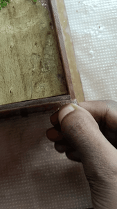

I used knife to create a gap for easy peel off after removing hot glue, but be verycareful as wrong you could end up scratching your master piece. so start pulling in sides too.
