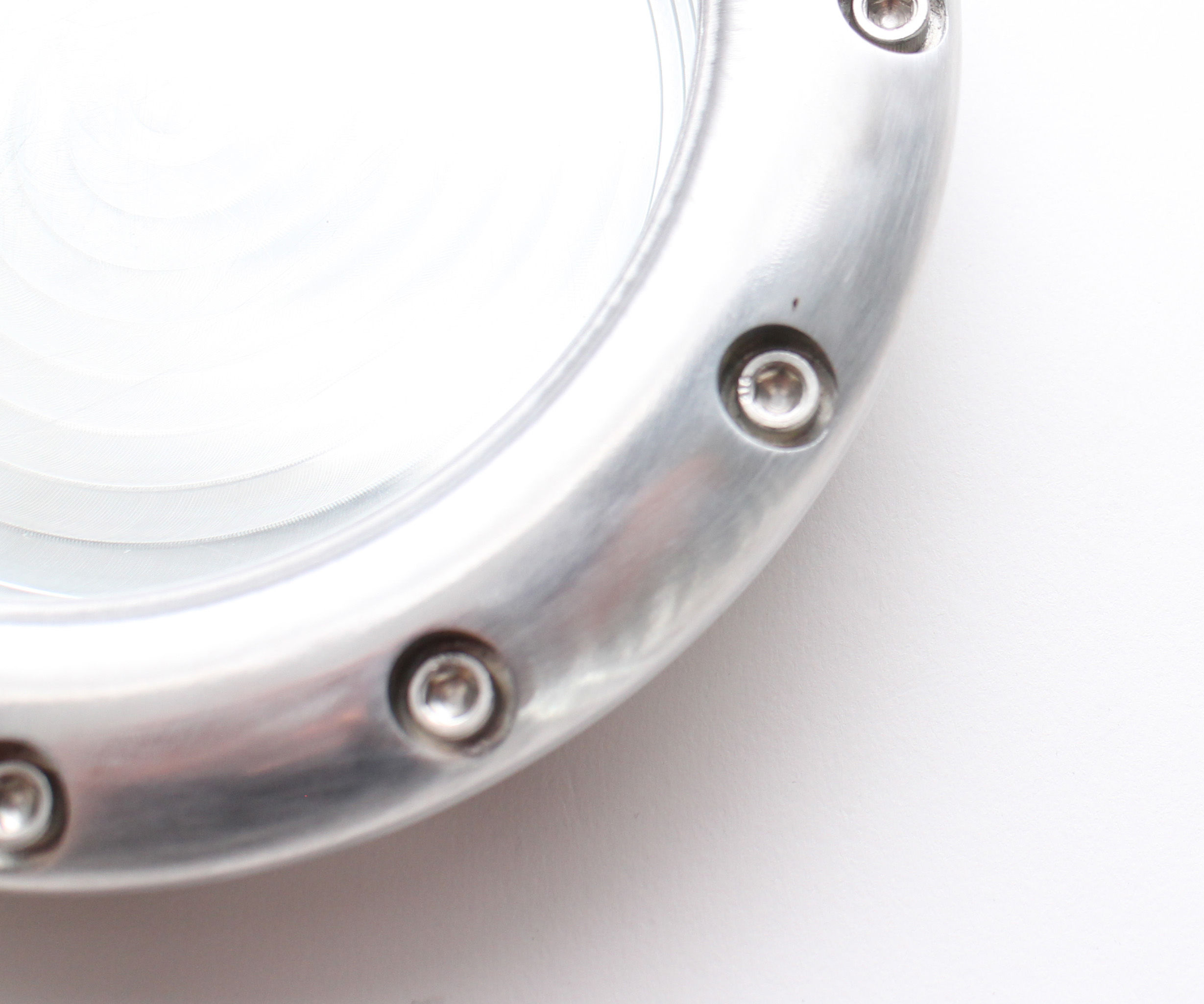

Step 5: Metal Part Fabrication
The glass vessel's purpose is to provide buoyancy. For proper operation, a data buoy needs to have a set of electronics oriented towards the sky (for communication), and a shape that moves well with the waves. I relied on corrosion resistant aluminum to ballast the buoys. I created full physical prototypes of three different designs, and will test them in the water soon. The main function of the metal parts is to secure the electronics, keep the buoys upright, and dampen wave motion.
I accomplished most of this function with waterjet cut, routed and hand finished metal straps. My 3D Fusion 360 model was put together with 2D sketches. These sketches can be easily exported as dxf files, which can then be cut on the waterjet.
One of the designs was as simple as possible. A second had additional waterjet cut fins for counteracting the pitch and roll of wave motion. The third was the semi-spherical metal cap design. For this piece, I worked with some of the Pier 9 CNC experts to toolpath the Fusion 360 model in FeatureCAM from a solid 12"x12"x2" piece of aluminum stock.
