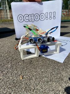

The project "ochoo" has designed a special pair of glasses with two ultrasonic sensors and a speaker that makes sounds if obstacles are near. We built this project with the aim of facilitating lives of blind people.
The structure of the glasses is 3d printed with a classic plastic filament. The two sensors are above a rotating servo motor so that it's possible to have a 180-degree view of the surrounding obstacles.

Step 2: Assembing
  • Holes are drilled a few millimeters in diameter.
  • The frame is assembled with the rods to support the glasses.
  • If necessary wire and glue are used.

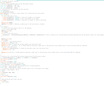

Step 4: The Program
We programmed the Arduino using the C+ language for operating the system.
The ultrasonic sensors generate a pulse train. When the ultrasonic sound waves reach an obstacle they echo back and are detected by the microphone. At that point, a signal is sent to the buzzer to warn the user of the presence of an obstacle. Currently our prototype can detect obstacles at a distance of up to half a meter only.
