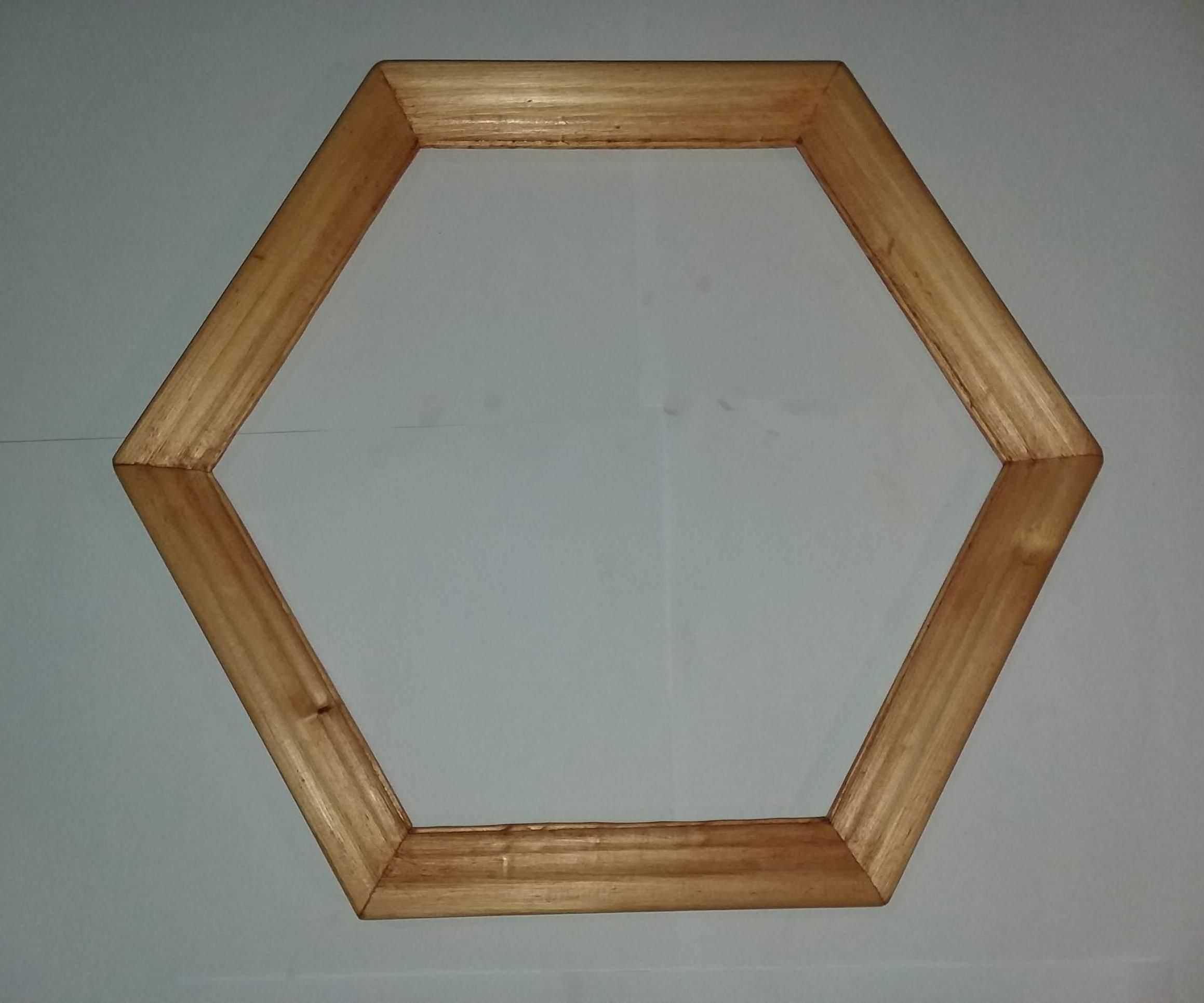

I have used octagonal frames for some projects and find them attractive. The first photo above shows a frame constructed using these plans. The second photo shows the backing that fits inside the frame. It is quarter inch birch plywood.

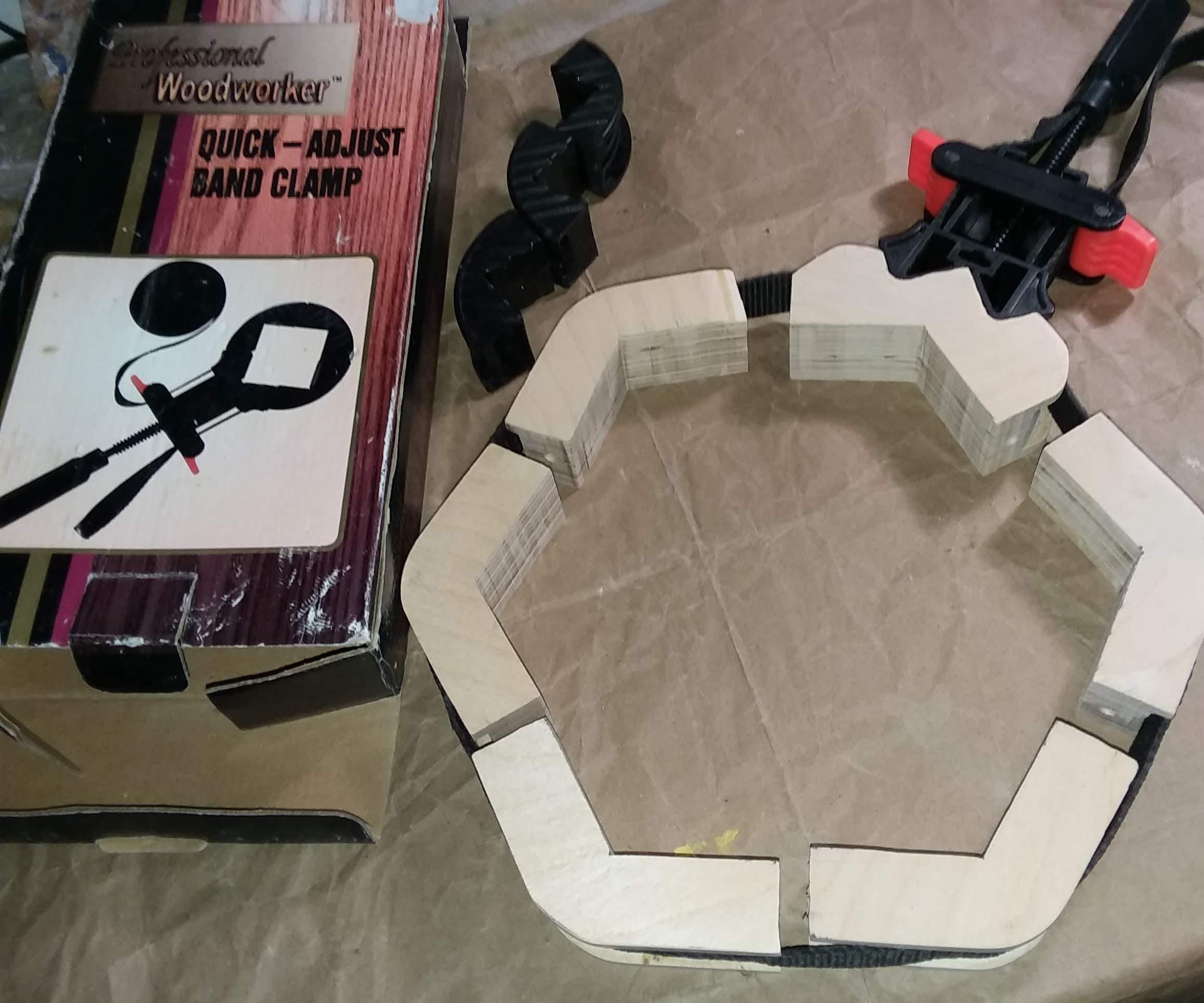

Step 2: Modified Strap Clamp
Holding the frame together while it dries is a challenge. I modified a strap clamp designed for 90 degree corners. As you can see in the second photo, one piece had to be cut specially so it fits on the main piece of the strap clamp. There were seven other pieces, each the same.
In the third photo, you can see that each piece of the clamp has an angle of 135 degrees on the part that will face the frame during gluing. I use blue tape to prevent the jig from sticking to the frame during gluing.
In the fourth photo, note that the back of each of the seven pieces is indented, so that the strap stays in place. I did that indenting with a router.
CAUTION. SAFETY FIRST: If you plan to indent small pieces of wood using a router, DO NOT hold the pieces with your fingers. That would be extremely dangerous. Instead build a jig so that each piece can be held securely against the router cutter while keeping your fingers far away from the router.
The fifth photo above is just to show how a frame fits into the strap jig which has now been modified for an octagon. That particular frame has already been glued together.
Step 3: Cutting the Sides for the Frame
Each cut with the mitre saw must be 67.5 degrees, half of 135 degrees. To achieve that, I set my mitre saw table at 22.5 degrees, because 90 degrees minus 22.5 degrees is 67.5 degrees. On my mitre saw, there is a detent at 22.5 degrees.
I set my mitre saw so that I could cut both ends of each frame piece without readjusting the blade. I also attached a stop to the mitre saw so that I did not have to measure each frame piece individually. My mitre saw is constructed so that it is easier to mount the stop on the left. However, it is possible to make very good frame pieces whether your stop is mounted on the left or right.
I cut one end, rotated the frame piece 180 degrees, moved it against the stop and cut the other end. Try this on scrap. You can get good results with only small effort. Having a stop is also handy if you find your frame is a little too large so that you have to trim a small amount from each frame piece.
Here again, I strongly emphasize the need for SAFETY. Keep your stop and your wooden pieces clamped against the mitre saw while cutting so that the blade does not throw them. Wear goggles and a dust mask. Keep your hands away from the blade.
