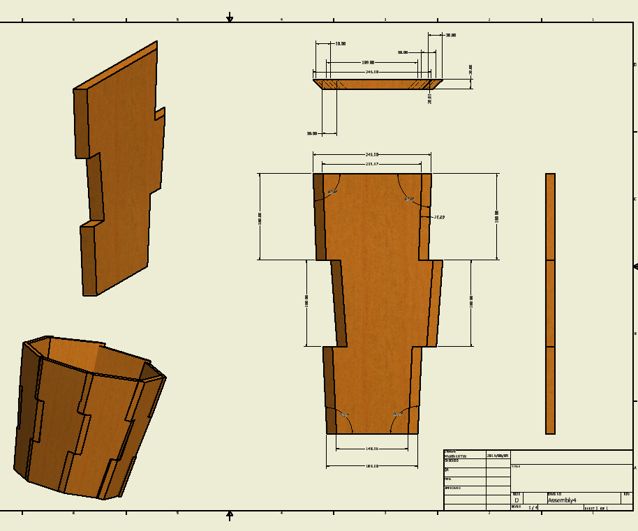

Step 2: Compile 3D Drawings
3d drawings of bench were compiled. (Each component and bill of quantity is added on the attached PDF)
The initial plan included backrests, but this was not constructed as seen on the assembly drawing and final photos.
An updated drawing with scale of 1:10 for each component has been uploaded.
