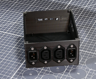

Step 5: Mount the IEC Sockets in the Case
Now we're going to take a moment away from the PCB and the Pi to mount the IEC sockets into the 3D printed case. Mount them using M3x12 screws with countersunk heads and some M3 nuts. Doing this step now is ideal because getting the nuts on for the bottom bolts in particular can be quite tricky, and the case is as empty as it will ever be at this point.

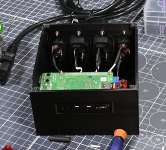

Step 6: Mount the Custom PCB and Pi in the Case
Next, take the custom PCB assembly with the four standoffs still attached to it and the Pi tethered to it by the wires and set it into the enclosure. Then, install the M3x6 screw in the corner of the board that's located closest to the Pi's headphone jack to secure it partially to the case. Then, take the Pi and wiggle it onto the standoffs and get all of its I/O lined up with the holes in the sides of the enclosure. Once the Pi is on the standoffs, you can secure it with the four M2.5 nuts, and you can also install the remaining three M3x6 screws that will mount the custom PCB to the case.

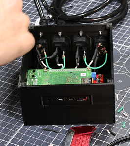

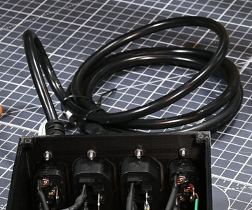

Step 7: Wire Up the IEC Sockets
Use the 18AWG wire and heat shrink tubing to connect the IEC sockets to the screw terminals on the boards. The live and neutral connections on the IEC sockets should be labeled, and the silkscreen on the PCB also points to which wires go where. Just know that the male sockets (the two outer ones) are the ones that the "IN" connections should go to, and the "OUT" connections go to the female (two centermost) sockets. Plug in extra IEC cables that obviously aren't live to the sockets you're actively soldering on to mitigate the risk of melting one of the pins out of its correct spot.
After the live and neutral connections are made, use two more pieces of wire to connect the earth connections on the two rightmost sockets to each other and the earth connections on the two leftmost sockets.
