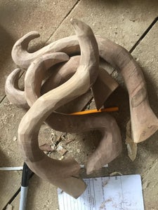

Step 6: Carving the Tentacles
Now we can carve each Tentacle. I used a angle grinder for speed here with a aggressive sanding disc on it to remove the waste quickly. You want to keep the Tentacles round and consistent until you reach the tips. Here you reduce the to a dull point.
If your Tentacles splay outwards slightly then now is the time to grind an angle to the flat parts at the end where they are due to meet the body. This can be tricky to do at first and is a case of trial and error
