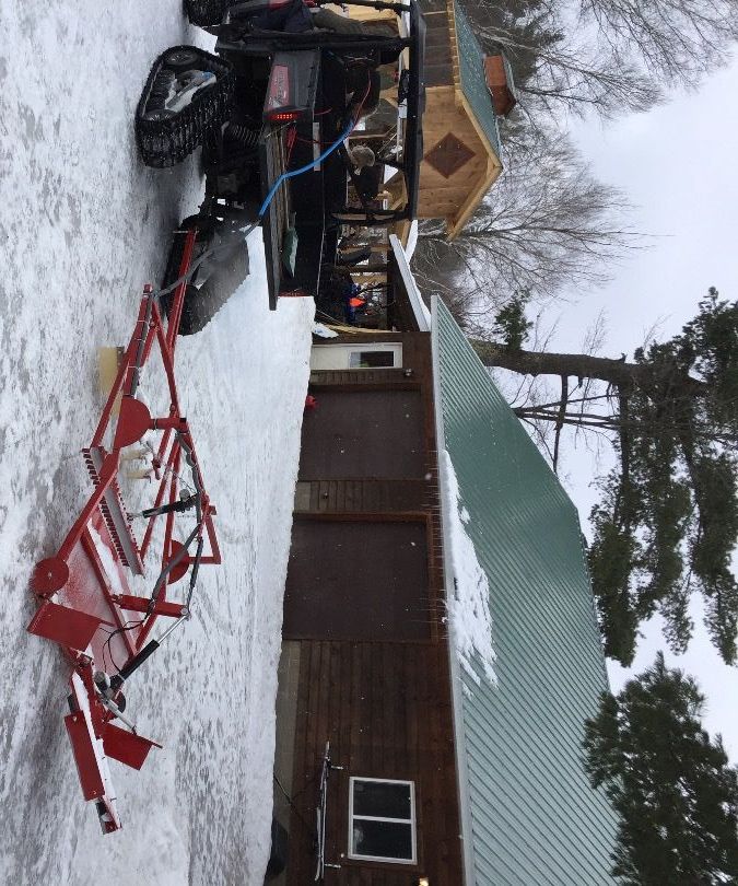

The traditional method for gathering maple sap has been to drill a hole in a maple tree in early spring, insert a tap in the hole, and hang a bucket on the tap. You then collect the sap from the buckets and haul it to an evaporator for processing. I have used this method for decades. It's low tech, simple and effective. Carrying all that sap is also a ton of work and hard on your body if you have lots of taps in. This year, in northern Wisconsin, it would have been impossible given the heavy snow cover on the ground. In the last couple of years I have been pondering how to set up a 3/16 inch pipeline. The problem I faced is that my maple trees are on flat ground in a remote location away from any power source. Gravity fed 3/16 inch pipeline systems require 50-60 ft of drop from the first tap in the line to the collection point to develop maximum vacuum and I only have 6-8 ft. One way around this is to use a vacuum pump, but I have no access to power to run a commercial maple sap vacuum pump. Additionally, commercial maple sap vacuum pumps are large, expensive, and complex - designed for big operations with extensive pipelines and thousands of taps. I wanted an inexpensive, environmentally friendly 12-volt system I could power with solar panels that would serve a couple of hundred taps. Enter the Shurflo pumps and inspiration from Spruce Creek Farms in Ontario, Canada. These 12V pumps are designed for use in RV's and boats. They are diaphragm pumps that have two attributes that make them perfect for this application - they can run dry without damage to the pump and they can handle the freezing and thawing that is integral to maple sap production. I have now built such a solar powered vacuum pump maple sap system and it’s working great. This Instructable tells you how to replicate my vacuum pump system.

You will need some sort of pump to pump the sap out your collection tank into whatever tank you are using to transfer the sap to the sugar shack. I use a 12V 350 gal/hr transfer pump to transfer the sap from the collection tank to a 125 gal transfer tank on the back of my gator. The transfer pump is connected to the battery with large ring terminals. I have a short piece of garden hose with a shut off tap running out of the collection tank and another hose running from the transfer pump to the transfer tank.
