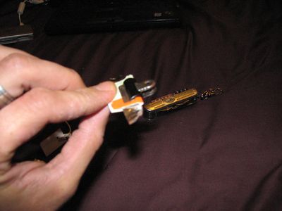

Step 2: Constructing the Switch.
Cut off a bit of card big enough to fill the jaws of the clip once folded in half and then some. You don't want the croc clips touching the metal bulldog clip as that would be rubbish.
Fold it in half
Take the foil (I folded it in half for strength but a strip of tape would work better) and attach to one half of the card with blutac or double sided tape. Try to place it so that it receives the mostr pressure from the bulldog clip. the metal needs to be exposed. leave enough hanging out the side to attach the croc clips to. Repeat on the other side, making sure that when folded, the touch and that the overhang is on the other side.
Fold it in half

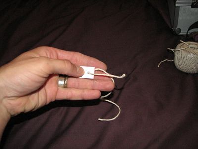

Step 4: The Trip Mech
Add hole to card.
Tie string through hole (the longer trip wire string)
Make sure card is wide enough to prevent any shorts within the trip switch.
