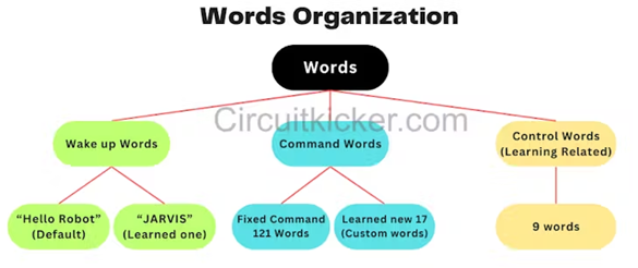

I will try to keep it as simple as possible, I will divide all the words in 3 sections as per action. See the block diagram given below.
1)Wake-Up words: The wake-up word refers to the word that switches a product from standby mode to operational mode. It is the first command which is given to wake the module. It is similar to saying “Alexa”, “Hey Siri”, “OK Google”. Same as that here the default wake up word is “Hello Robot” and it is the default one. We can also add one more wake work which is demonstrated below as “JARVIS”.
2)Command words: Fixed command words refers to the designated vocabulary used by users to issue specific instructions. Here these words are essential because, after all, this is an offline module and does not have external data/server from the internet to process. So these are the already processed, trained words which are stored in the memory of the module and whenever triggered produce the corresponding ID, which can be used to specify the different actions later on. There are a total of 121 words which are already defined for specific functions over different ID’s.
Now whenever working on a project it is not always good luck that these commands work for you. Means sometimes we need some other commands. Which is possible to do here, known as a custom command word. And there are a total of 17 Custom command words you can train the model on. See all commands from here.
3)Learning Related Commands (Control Commands): These are the command words which are used to interact with the Machine learning model. These are the Controlling commands which initiates the learning and deleting of Wake-up words and command words.

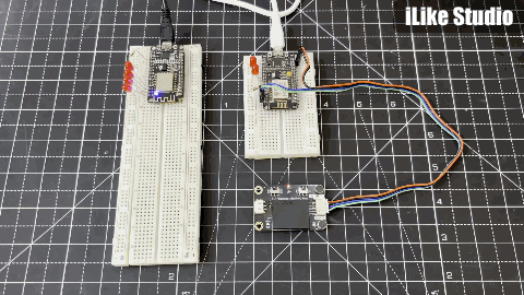

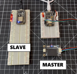

The idea is to first connect the local host to an offline voice recognition module and connect the wireless host over ESPNOW. In this way multiple GPIOs can be used to control different appliances. In this way multiple wireless hosts can be connected to the network and the central local voice recognition hub sends commands to each of them in order to switch ON/OFF. But that is the topic for another day.

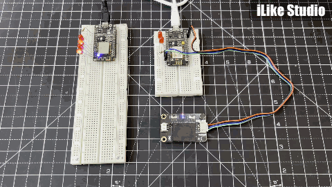

The ESPNOW is good protocol to use wireless, but using it with ESP8266 gives some difficulties, if not properly written in the program it ruins everything. I tested my units many times and was happy to see that they are in working condition every time.
I have tested the voice commands and they are working perfectly, the video for the same is attached here for your reference. The ESPNOW is easy to use just plug and power both ESPs and it will automatically make a connection, see the code for wifi MAC settings. After a successful connection serial prints the same information to validate the connection.
