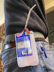

No one wants to carry an oil can around with them as they work. My answer to the problem was an oil can holster.

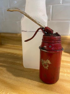

Small (6 ounce) pump type oiler

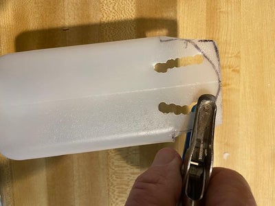

Paper hole punch

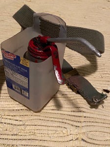

Stand the oil can and the milk bottle next to each other and use the Sharpie to mark where the plastic should be cut. Leave one side of the plastic as high as you can for the belt slots. The other three sides are cut just low enough so the oil can will fit inside the milk bottle and will still be easy to retrieve.
Use the scissors to cut away the top of the bottle. Use the hole punch to remove adjoining rounds of plastic to form two slots. Insert the belt through the slots, put on your oiler holster, and insert the oil can.
