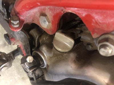

Step 1: Step 1 Check Oil
Make sure the bike is level and check the dipstick to see how much oil is in the bike. You do not need to screw the dipstick back on each time to get an accurate test. Once you do this you can put the kickstand down and re screw the cap on.

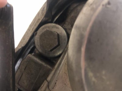

Step 2: Draining Oil
Put the kickstand down. Putting the kickstand down helps hold the bike up and it also leans the bike which makes it easier to drain the oil.
Step 3: Putting Oil Plug Back In
Unscrew the bolt behind the shifter on the kickstand side of the bike (There is a spring behind the bolt with a little metal filter).

Step 5: Check Oil Again
