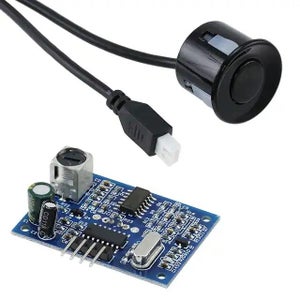

  • Waterproof Ultrasonic sensor

Step 3: Connect the Ultrasonic Sensor
Next, we need to add the Ultrasonic sensor. VCC and GND of the sensor are connected to 3.3v and Gnd respectively, whereas Trigger goes to pin 25 and Echo to pin 26.
