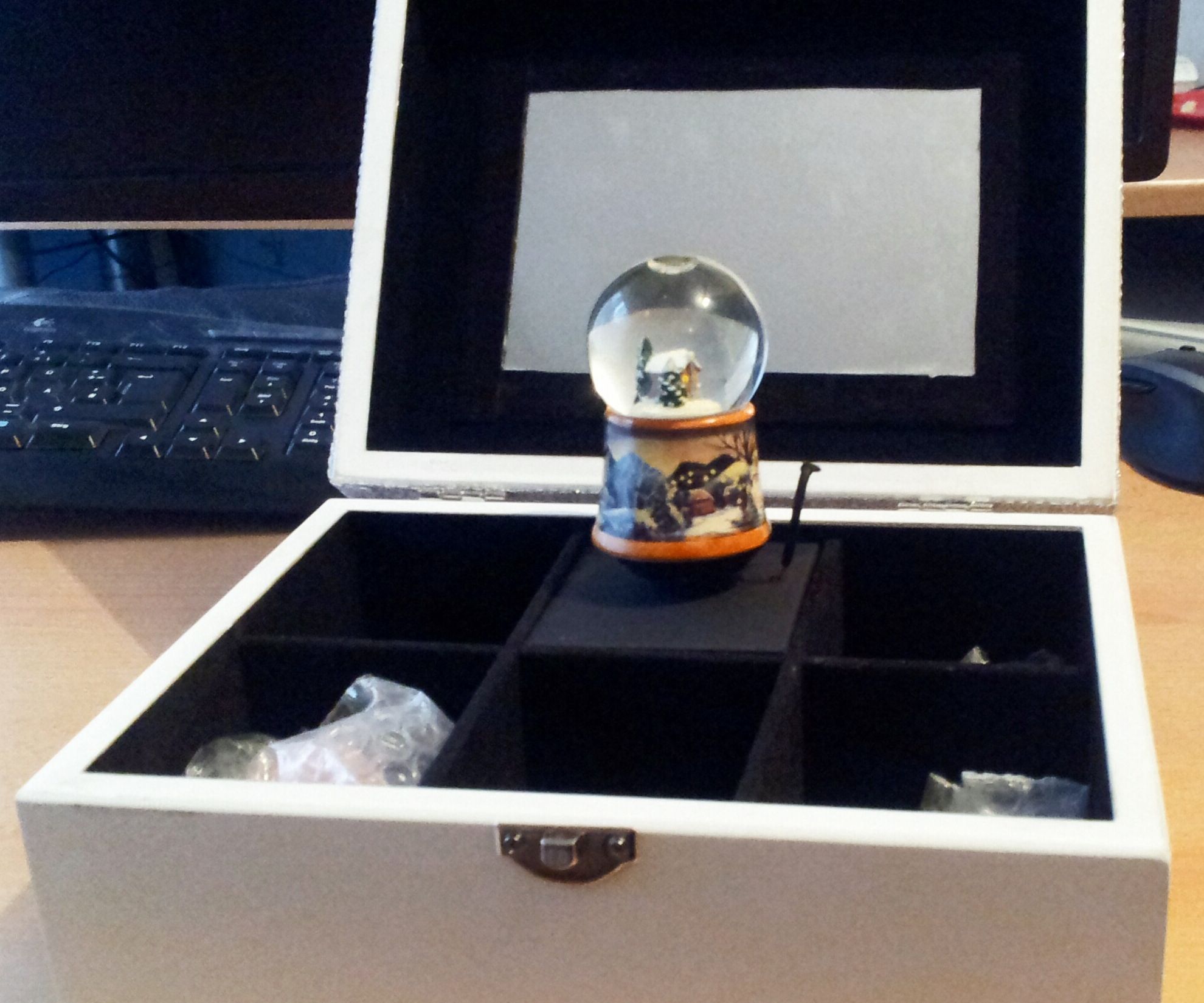

Step 4: Mounting
Next step: mounting the components on a fixed plate. (e.g. on a laminate plate)
I have welded a screw on the middle of the disc, to mount it on the engine.
Step 5: Test
I have only choose a 8V transformer for the LED, it is not so bright like 12V but that way you don't need a fan to cool.
Step 6: Case
Step 7: Completion
I wanted to make it without a fan but I safely install a fan, because some heat formed by the engine and the led.
