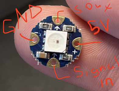

For the alarm controller, the wiring scheme is fairly simple. Daisy chain your neo pixel flora lights with the poorly drawn diagram above in mind. The root neopixel attaches the up arrow to signal, the + to 5v power, and the - to ground. Then every next neopixel attaches the same way but daisy chained to the previous, - to -, + to + and up arrow to down arrow.
For the speaker, the only wiring that needs to be done is to attach signal and ground to the female mono jack so that any mono aux speaker could just plug into it.
And that's it!
For the toothbrush controller, the only other piece being added to the board is the magnet latch. The wiring is very simple, just signal and ground to your esp32. That's it!
